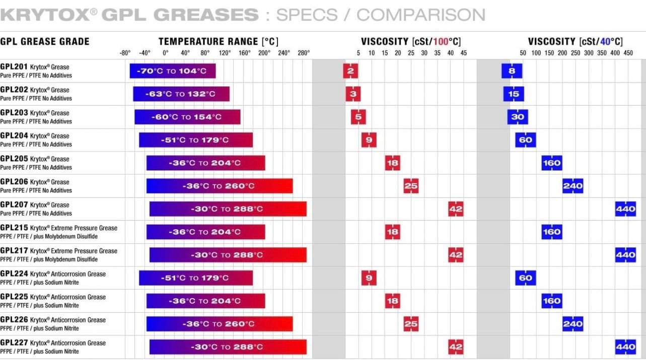

Use Krytox lube , dont skimp on product.

Well, I ordered three tubes of the Krytox by Chemours GPL 205 Grease. It should be here on Saturday. I know what I'm doing over the weekend.

why did you pick gpl205?
I’ve found about 10+ different versions and not sure which one is actually the best of the bunch.

The Krytox GPL 205 is what was stated in the video. It is what was mentioned in the FORD TSB 16-0020 for Sunroof Maintenance. I figured I would give it a try.
