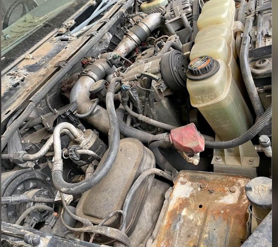

Is this an early 99 spyder? Seems to be to me. All I have are these photos.

Yes judging the air heater element not being present and the small size of the turbo.

and steel battery trays, if this is in a junk yard I would grab the driver side battery tray, there used to be people looking for them for their late 99 to 03 trucks to use when doing the 6637 air filter

Thanks all. Not sure yet if I’m going to pull the trigger. He’s asking $400 for spyder, pipes and cooler. Seems to be a good deal.
