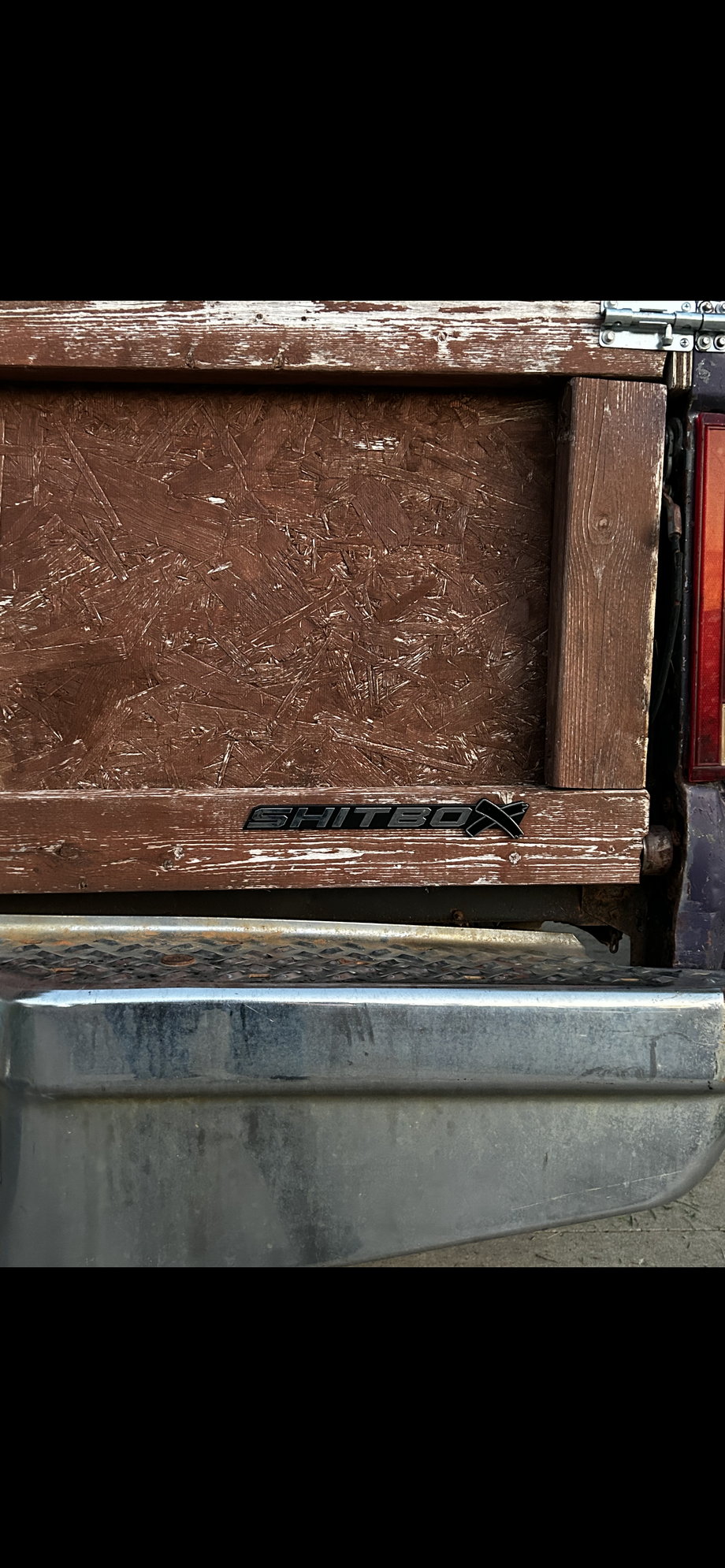

Since I’ve acquired my 83 F-150 I’ve been looking into replacing the bed, as it now runs great and the cab and front end have little to no damage or rust. But the bed on the other hand is far beyond repair and missing large sections due to rust. I have been looking for a 80-86 in fields or for sale for parts but have had no luck. Is there any other years in which the box would fit? I was looking at a 90 and they look very similar but I’m not too versed in that knowledge, I’m pretty new to this. And if no other years will fit does anyone have suggestions on where I could find parts? If not I may just go the flat bed route.

sides are pretty beaten and dented, and on the rear end bottom near where it meets the bumper they’re completely rusted out and missing big bites on both side, along with some rust holes in the front of the bed near the cab. The inside of the bed looks as though it’s been patched in a place or two and it’s not too terrible in there, just on the bottom of the outside near the front in back. Also to add on to it, there’s no tailgate. That’s been rigged up with wood and door latches, so a whole replacement would be ideal if I can find one.
