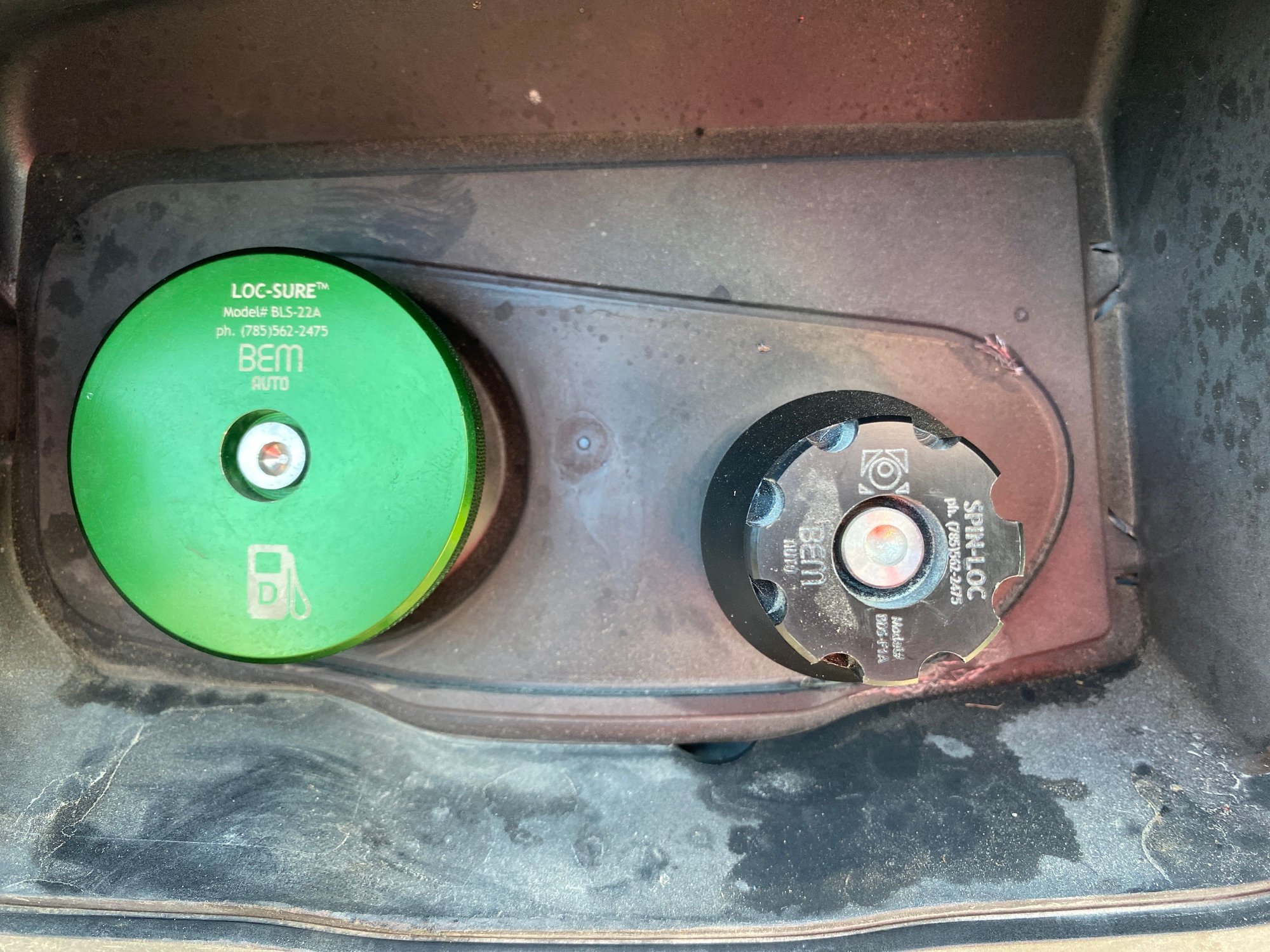

Right, but it was a gal service rep who said it was coding O2 sensor on the dealer services PC. I think she or their computer was wrong though. The phone app said it was a NOx sensor that stopped responding. The crazy thing is the dealership kept the truck overnight, replaced the sensor, but I didn’t notice until yesterday that my DEF fill cap magically disappeared. FYI that is a 31.00 replacement. I'm left wondering, was it collision repair center from hail damage repair or was it the sensor replacement that required removing the bed because the DEF cap was pinched under the bed, some moron forgot to remove the cap or at least ensure it was properly replaced when the bed was reattached. And if anyone has a good security solution for fuel/DEF access port. So far I have only found a locking fuel cap, feel free to respond. The door cover access to the fuel and def ports doesn't look like it can easily be modified to put on a custom lock.

Originally Posted by big_colo
Right, but it was a gal service rep who said it was coding O2 sensor. I think she or their computer was wrong. The phone app said it was a NOx sensor stopped responding. The crazy thing is the dealership kept the truck overnight sensor replaced, but didn’t notice until yesterday that my DEF fill cap magically disappeared. FYI that is a 30.00 replacement. I’m left wondering why and what kind of coward steals these. And if anyone has a good security solution for fuel/DEF access port. So far I have only found a locking fuel cap.

Originally Posted by cpobst
X2, have been using this combo a long time now. You can have both keyed the same. Keep one in the truck in the center console and the other on the spare key.
You can use one have a unlock it just like you can turn a screwdriver with one hand.
I'm aggravated these **** ers don't make one for the older gen guys... lockable DEF cap that is.

Thanks for the tip on BEM. I saw these on Amazon. On my 03' Ranger I bought a Stant, and on my previous vehicle as well, as I have only owned 3. Stant caps are typically pretty reliable. You just have to be careful for when you have emission check done because that requires cap check as well and ensure the tech gets the right key. I was almost in a dilemma on that. Also in case anyone needs the tip the behind the cap insert just pops out from the left side. Under you will find the ports mount with a clip and very small <7mm hex screw. Funny thing about that too is on the wonky rubber pop out the fuel port was centered but the DEF port was not centering where it mounts.
