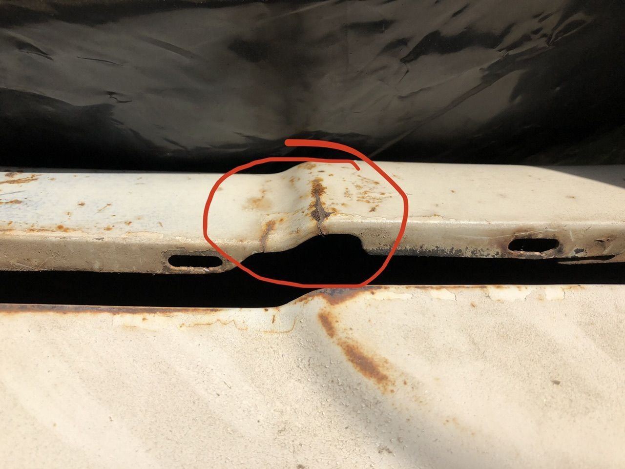

Are you talking about these cracks?

Common spot. When welding, I would put a little backing plate in there....

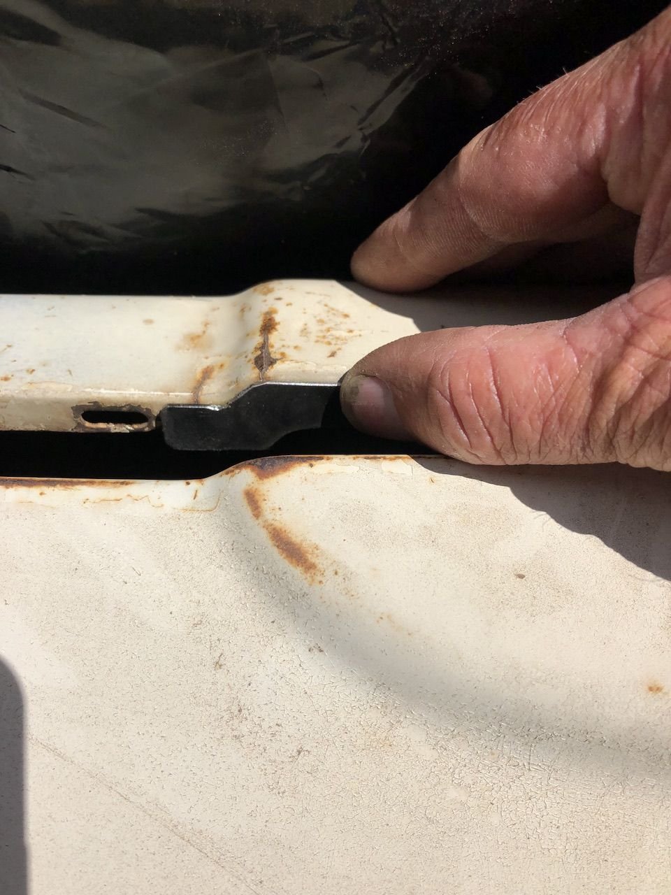

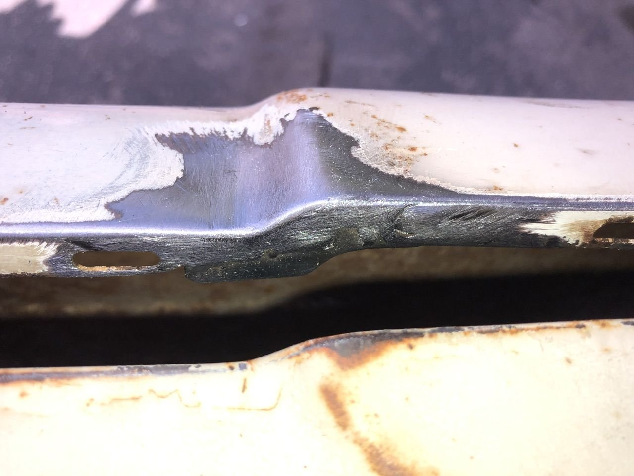

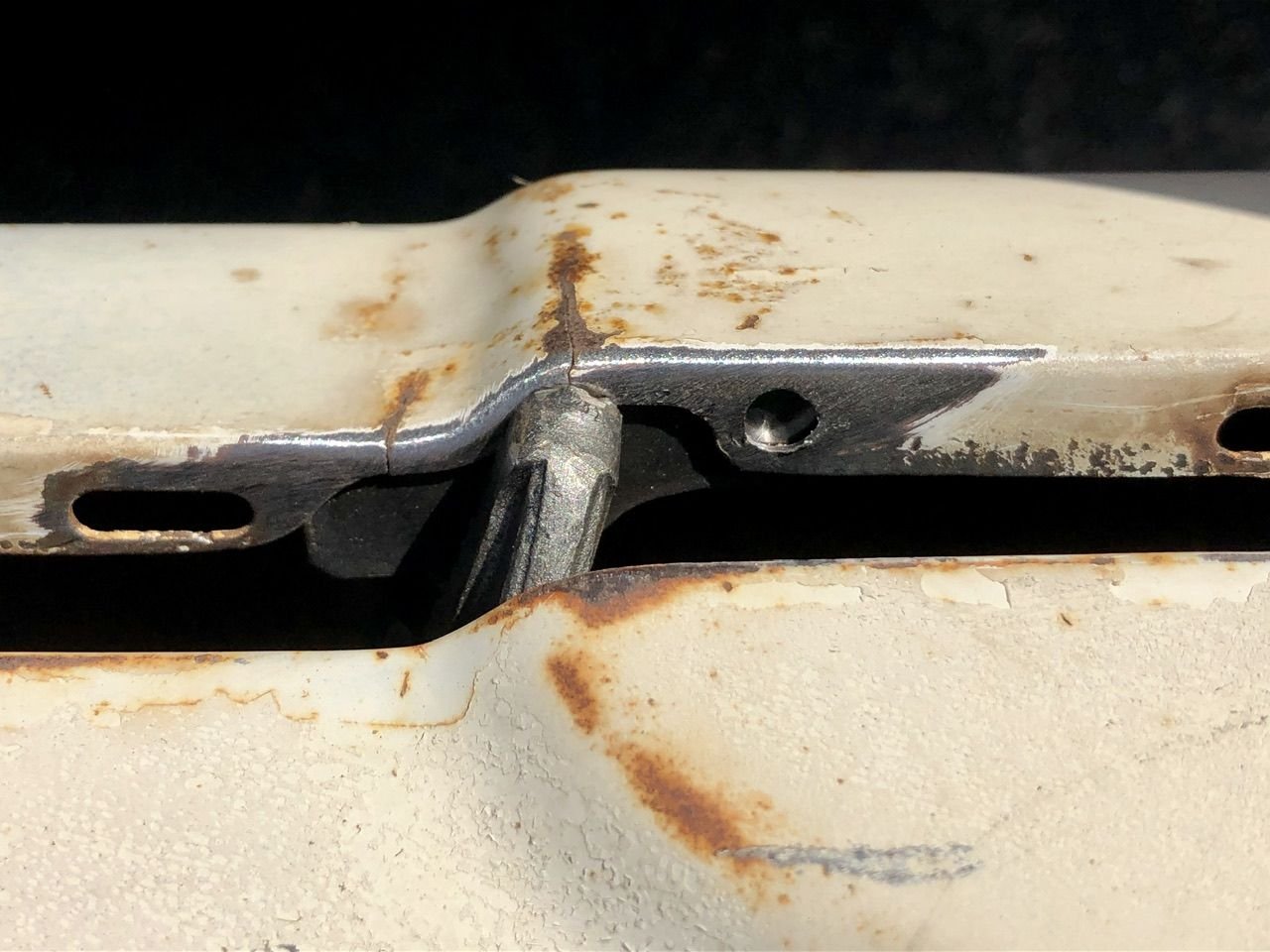

The reason it cracks there is because of the void in the area below the crack.
The key to stopping the cracking is to fill in that voided area. The door will no longer flex in that area.

Nice fix
I did see that void and thought no wonder why it cracks there.
