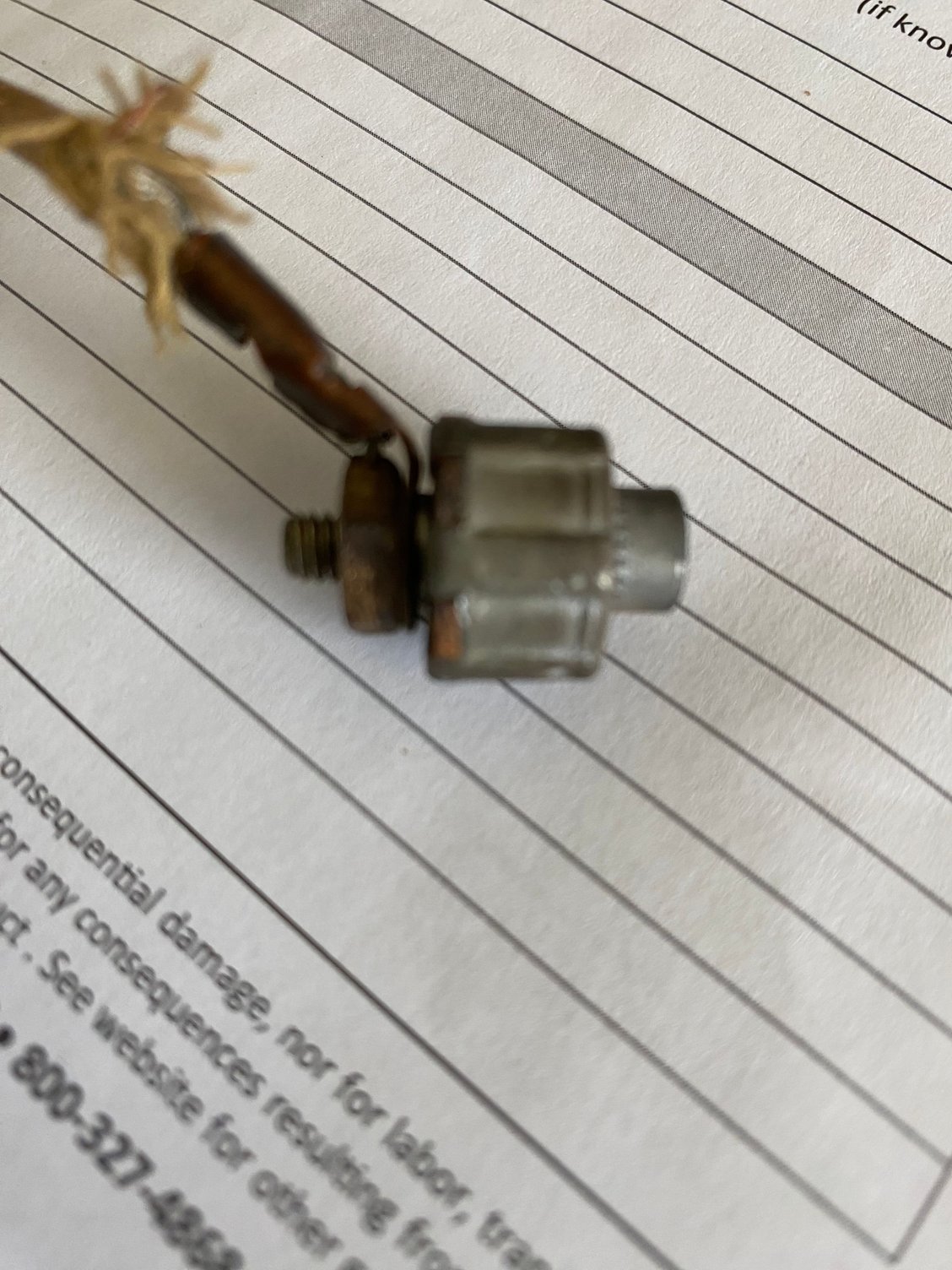

What is this?
This was screwed onto the back of the cigar lighted on My 55. Is it a voltage reducer, a fuse? Can I just remove it? I'm replacing the lighter socket.

Good puzzle. I would check it's output voltage

Its a fuse

I looks like the part that came off my 1955 originally it was six volt positive ground. The PO went to twelve volt and used several voltage reducers on instruments , electric WS wiper and heater motor. All were burned up, AJ

It has no continuity so I thought it was a fuse.
Thanks for the confirmation.

If it is indeed a burned up voltage reducer then there's no harm in bending those little tabs back and see what's going on in there! I've searched online and didn't see anything like it.

With a 55 I am guessing it's a fuse. I found something simuliar on the back of my lighter on my 56 but it was ceramic if I recall correctly and checking it with my ohmmeter it was open. Mine looked more like a dropping resistor which to me made sense as 56 was the first year of the 12 volt systems. My theory is Ford probably had who knows how many 6 volt cigarette lighters left over. It looked to be a wirewound resistor so it also could of doubled as a fuse since too much current draw from the lighter element could of burned the wire inside the ceramic resistor open. Mine was burnt and discolored for sure.

Not for a 1955 with 6 volt system. My 1958 Mercury had that so it must have been replaced at some time....
