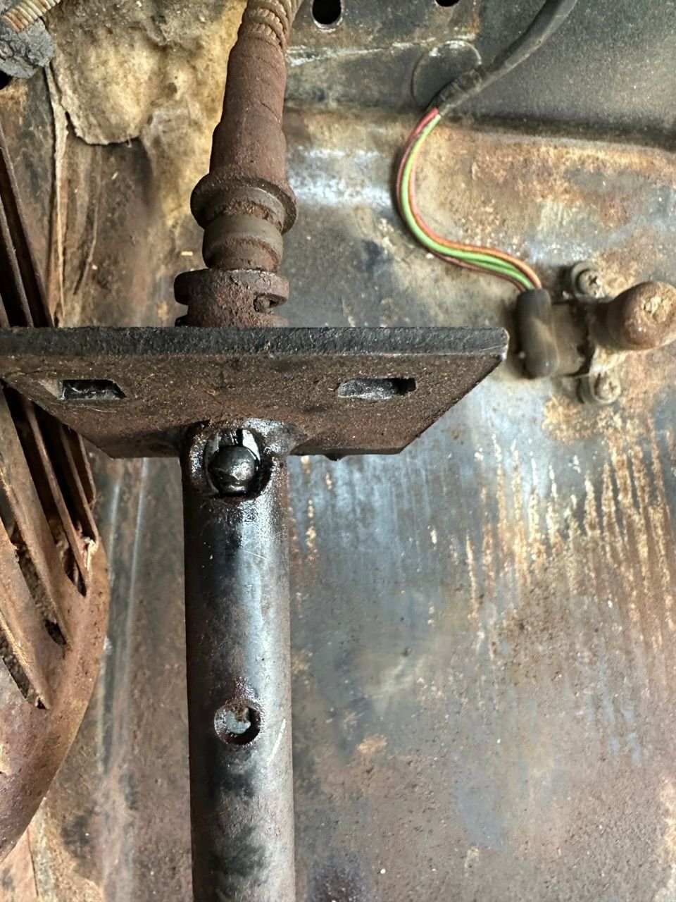

Spurredon you are correct! To get the front emergency brake cable off the handle assembly You've gotta pull this ball out of the shaft. Mine was really hard because the cable was frozen in the sleeve. The shaft is slotted with a hole for the ball on the end of the cable to lay in.
Found out what releases the cable.

That looks familiar!

Can you explain further what "pull the ball out" means? Which direction? The cleaned up portion?

In post 4 you can see the ball. It's kinda hard to get out. I think I fished it out with a very small flat tip screwdriver.

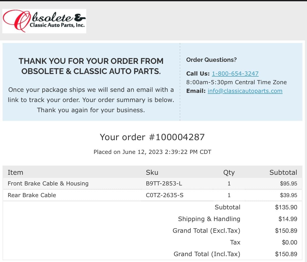

Bob, I got a new one but for the life of me I can't find the receipt. See if this helps https://www.ford-trucks.com/forums/1...ake-cable.html

Try this: 1960 Ford F-100 2WD Front Parking Brake Cable, OE Steel – Inline Tube
Old Nov 16, 2023 | 08:08 PM
bjmayberry2's Avatar
bjmayberry2
Veteran: National Guard
Joined: Dec 2012
Posts: 9,717
Likes: 823
From: Wentzville, MO
That diagram doesn't look anything like mine. Found my receipt.
