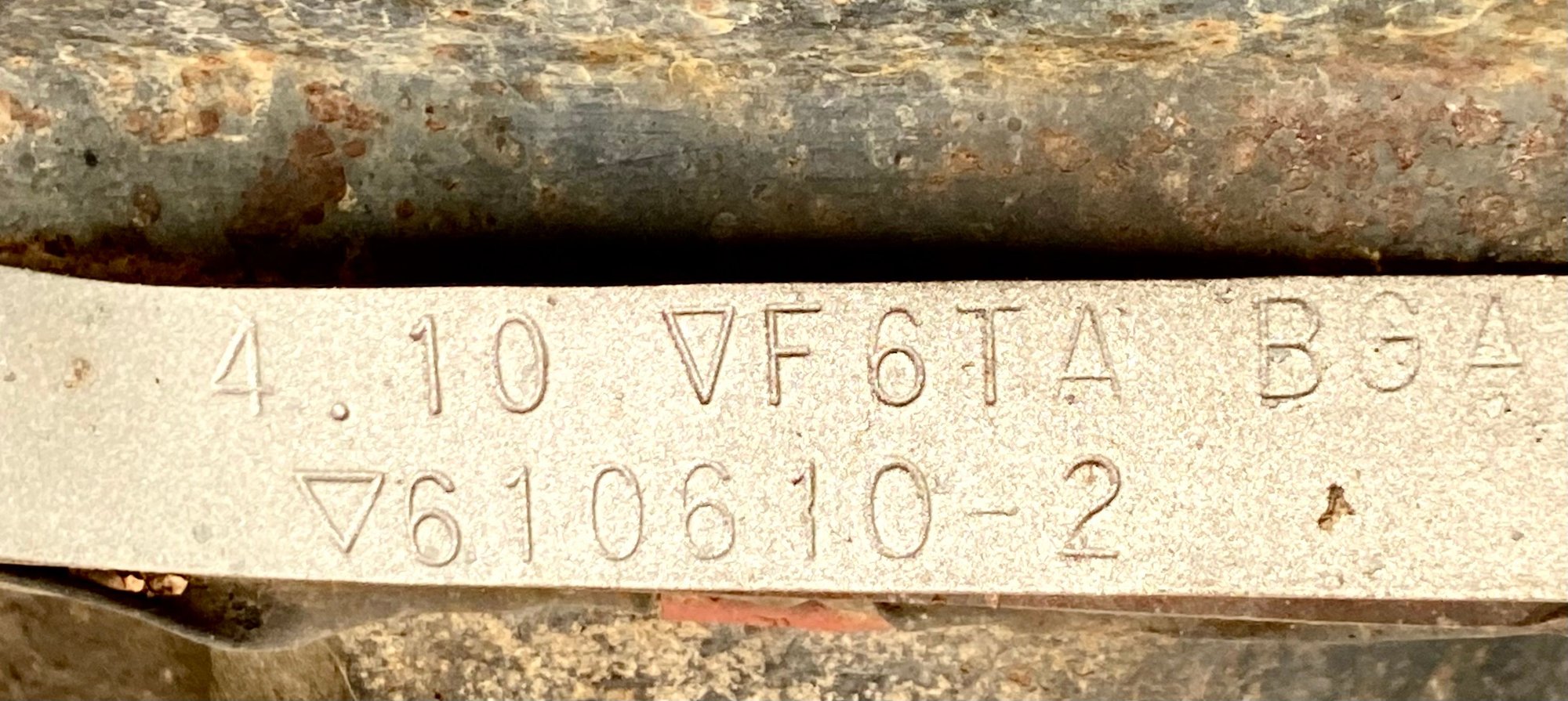

Hey y’all trying to keep up on all the maintenance on the farm and I cannot for the life of me figure out what front axle and diff I have so I can get a new gasket and change the oil. I know it’s 4.10 gears and the rear has a 10.25” ring gear. This is what the tag says………thanks I’m advance !!!

What vehicle? What year?

1996.5 - 1997 (Ford) Dana 60HD 4.10 ratio.
The BOM, 610610-2, is the key to knowing what Dana axle you have.
BOM = Bill Of Material
