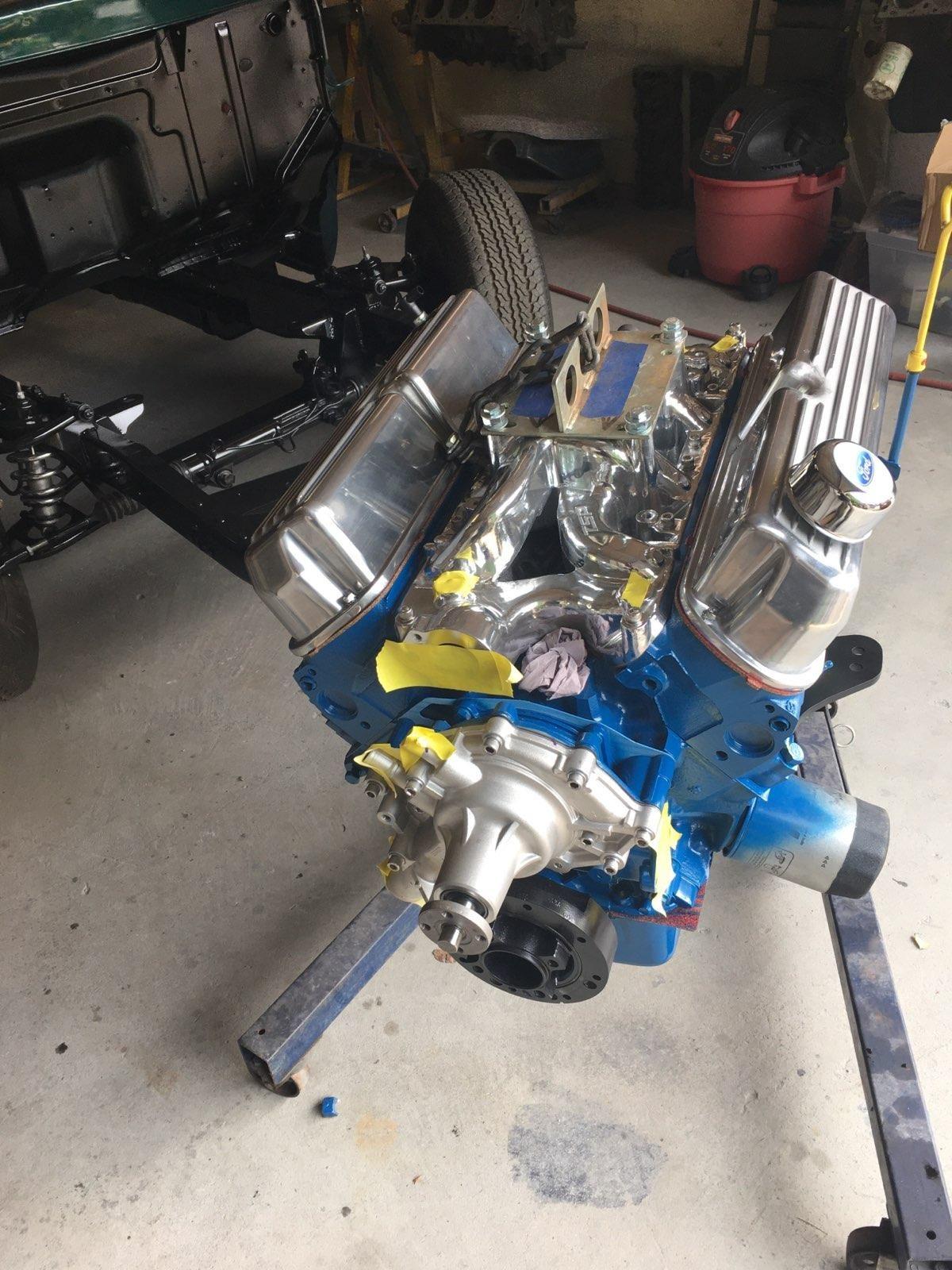

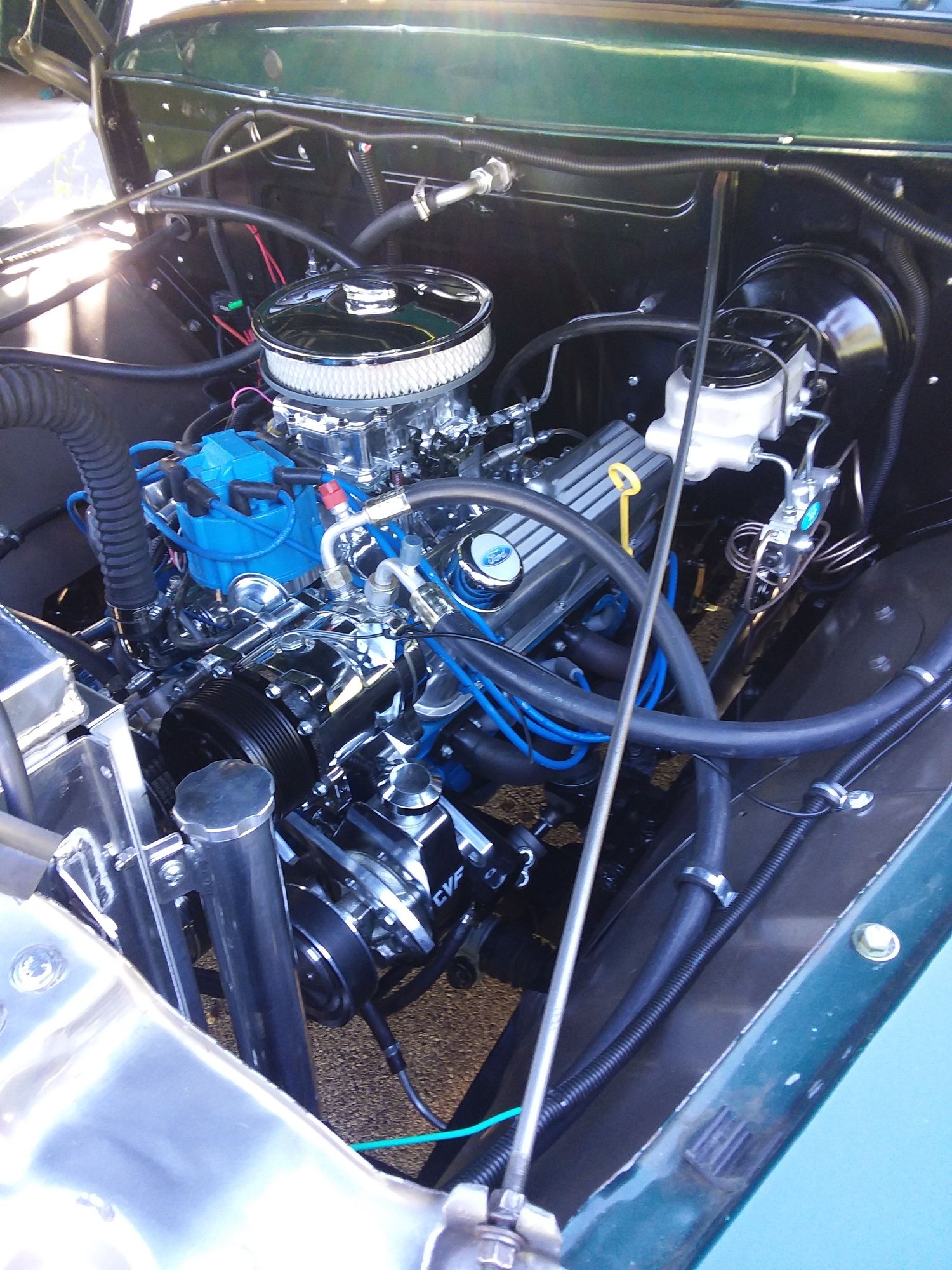

302
I always use the 5.0 engines--has roller cam and always convert them over to CARB engine-- EASY JOB and then you got a SUPER engine-- C-4 trans--- 1999 -2002 Explorer rears with disc brakes--TCI leaf spring kit---Mustang II front suspension -- THEN YOU HAVE A HELL OF A SAFE RIDE---
