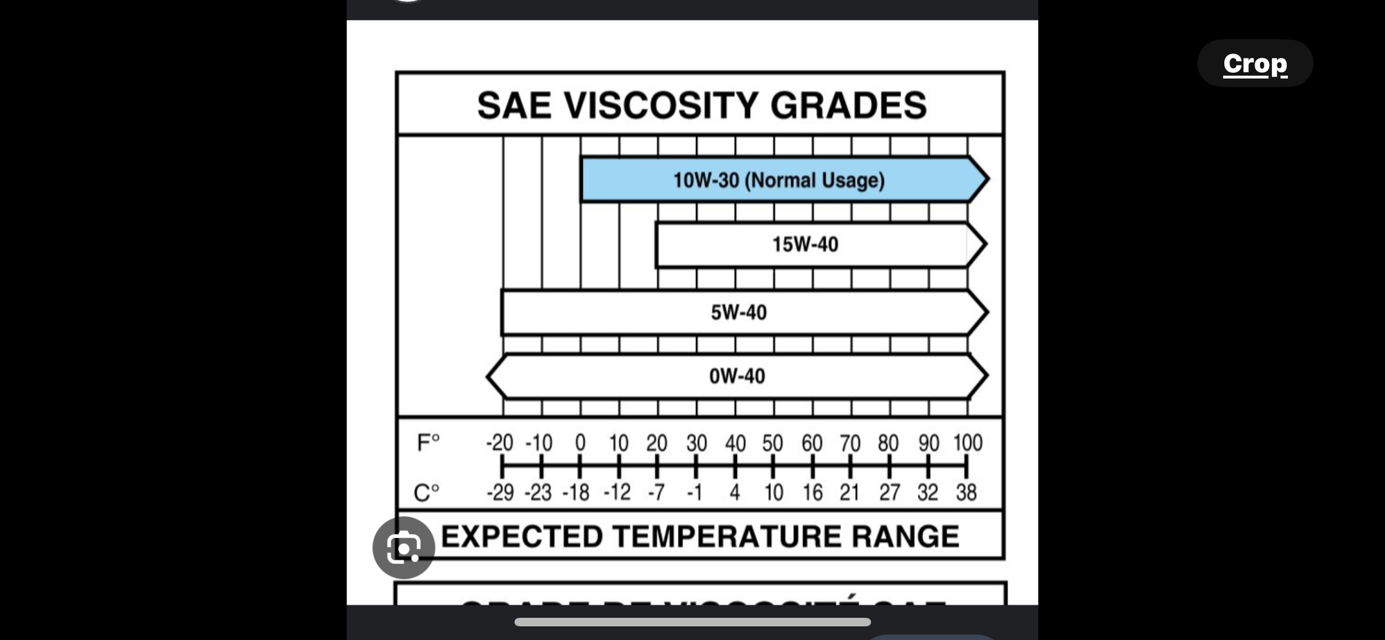

I’ve installed this with about 1500RPM set. Are there any discussions out there about starting the engine in cold temps with that high of RPM? I’m learning and I’m under the impression that oil isn’t pumped in the right places until several seconds after starting. Again, I'm brand new to the diesel world and watched a video from Dave’s Auto Center and was curious about a high RMP immediately after starting. Love the kit though. Works like a charm and heats up the cabin much faster.
thanks for any info.

Main thing is to review oil chart and have the right oil for the temp range you are operating in.
theres oil in the pathways from previous starts so the engine is now dry starting.
good oil that is not fuel contaminated sticks to metal well.
i got the diesel kit which has a dial so you can set any rpm in the idle kit range. So I can start at normal rpm and dial it up to where I want it .
i run 5w40 during cold months . If i was in the attic I would run 0w40.
A lot of folks run 10w30 which is good to 0 degrees.
wind chill doesn’t count.
