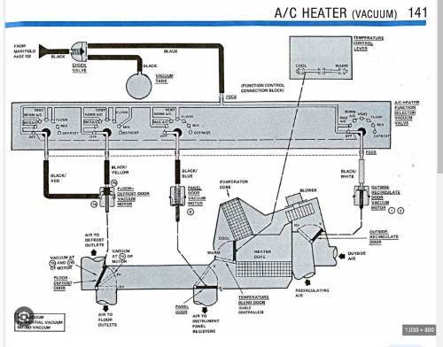

AC not working it will blow hotish air.
The heater core has hot water flowing thru it all the time.
The HVAC box is partly in the hot engine bay picking up heat.
The temp door is moved by cable behind the glove box IIRC so you can check that it is moving as it should.
The " blend door" that breaks is for defrost / vent / floor and the hinge breaks so it will not move.
Vacuum makes this move.
BTW if I dont have mine on AC it blows hot air and even more so when stop as the hot air under hood dose not get blown out.

On my '86 the blend door is cable operated. I've not had any problems with mine but it was my understanding that this is the door that breaks.

The heater core sits in the duct, downstream of the heater fan and AC evaporator. With the engine warm, the heater core is always hot. A cable operated door (Ford calls it the temperature blend door) routes air through or around the heater core, depending on the position of the upper lever on the control panel.
With the key off, move the temperature lever back and forth full travel. You should feel some resistance as the door moves, and hear a thump from inside the plenum as the door reaches full travel in each direction. If not, the cable may need some attention. This view, above the passenger's feet with the glovebox removed, shows the cable secured by the plastic orange clamp towards the upper right. Note the cover has been removed from the heater core:
The lever for the door (at the end of the cable) is in the shadows to the left of the clamp. I think you can snake your hand up there without removing the heater core cover, but am not positive. If you can hear the thump at each end of travel, there's no need to investigate the cable.
If the door is moving properly, the seals may have failed. I've never had mine apart, but think the seal is made of foam which may have disintegrated. From my understanding, it's a big undertaking to replace the seal and it may not be necessary if you add a coolant shutoff valve.

I highly recommend adding the coolant shutoff valve. It works very well and makes a big difference. I'd guess on any truck of this vintage, the seals on the temperature blend door have failed. Adding the valve is way easier than tearing the dash apart.
