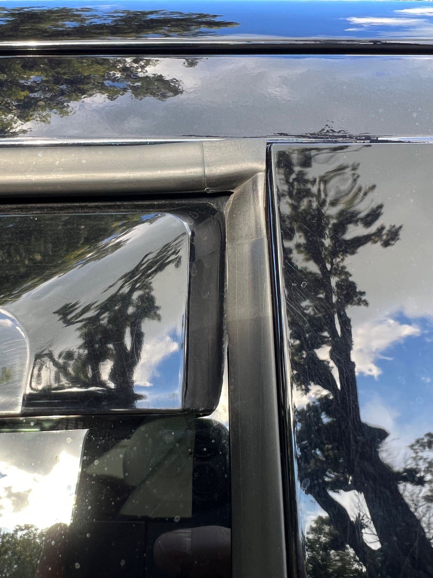

I had the same problem. And to be fair, when the guy at the parts department and I looked it up, we specifically ordered the ones that stick on rather than install into the channel... however, the in channel visors are what shipped... So, rather than dealing with returning them, I installed them. From the get go, the drivers side always hit. I constantly had to push the back corner out with my finger as the window was coming up to keep it from hitting the visor and going back down. Finally, after a few months, the corner broke off where I had been pushing it out. I used a file to smooth the break out and as it turns out, it works perfect now. Then almost immediately the passenger side started doing it, and within about a week or so, it broke off too. Now they both work fine. However, they have not aged well either... Admittedly, I haven't used any kind of plastic protector on them, but I wash my truck often, and make sure to wash them too. They just look kind of blah now... They also seem to feel a little flimsy too... I don't anticipate these lasting all that much longer, at which time I will go with another brand, such as the Weathertec ones. The only reason I have these specifically is because I wanted to use the FP points on something, so I got a set of these and on the rear wheel well liners. I definitely wouldn't order them again though.
Broken corner on Ford in Chanel visors... but the work better now...

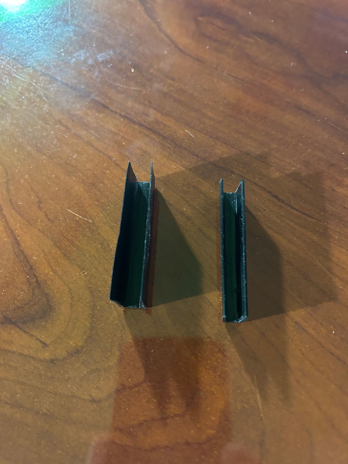

My Putco in channel ones work perfect for years, Hope you used the in channel guides that come in the box, They insert in the rubber window Channel for when the window reaches the visor. They're 2" long shaped like a u channel and spread the rubber weather strip open wider for the glass to go up. Call them and they will send them to you free.
Bigger one is for front windows , Smaller one is for rear windows
Weather tech only worked when I had putco send me some more and I used with the weather tech

Yea I get mine direct from putco and the last set I got didn't have them in the box, I had to call them and they sent them to me. Nothing in the Instructions either. They do work. I bought a set of weather Tech ones and had a problem bouncing back used the guides and been perfect since, Never left them rolled up for 48 hours worked ever since hot or cold. They were my answer ever since on all my trucks
