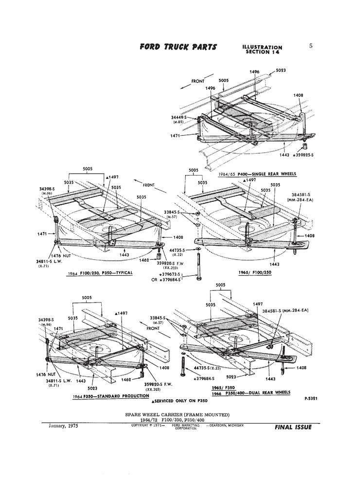

Wondering where they had the spare tire mounted at?? Have a 1973 f100 2 wheel drive, it has a driver side fuel tank and and a fuel tank in the rear behind the axle. It has the side mounted tool box on the passenger side bedside. It is also long wheel base. Thanks for any info...

Spare mounts up under the rear tank. There are a couple of options for that, plain and a swing out spare tire carrier.

X2 on under the rear gas tank.

Thanks for info and pictures...

Being that you and I are both in Missouri, I bet I have a spare tire main bracket (part # 1443) that I can part with and you can use all thread for the hdwr. PM me if interested.
