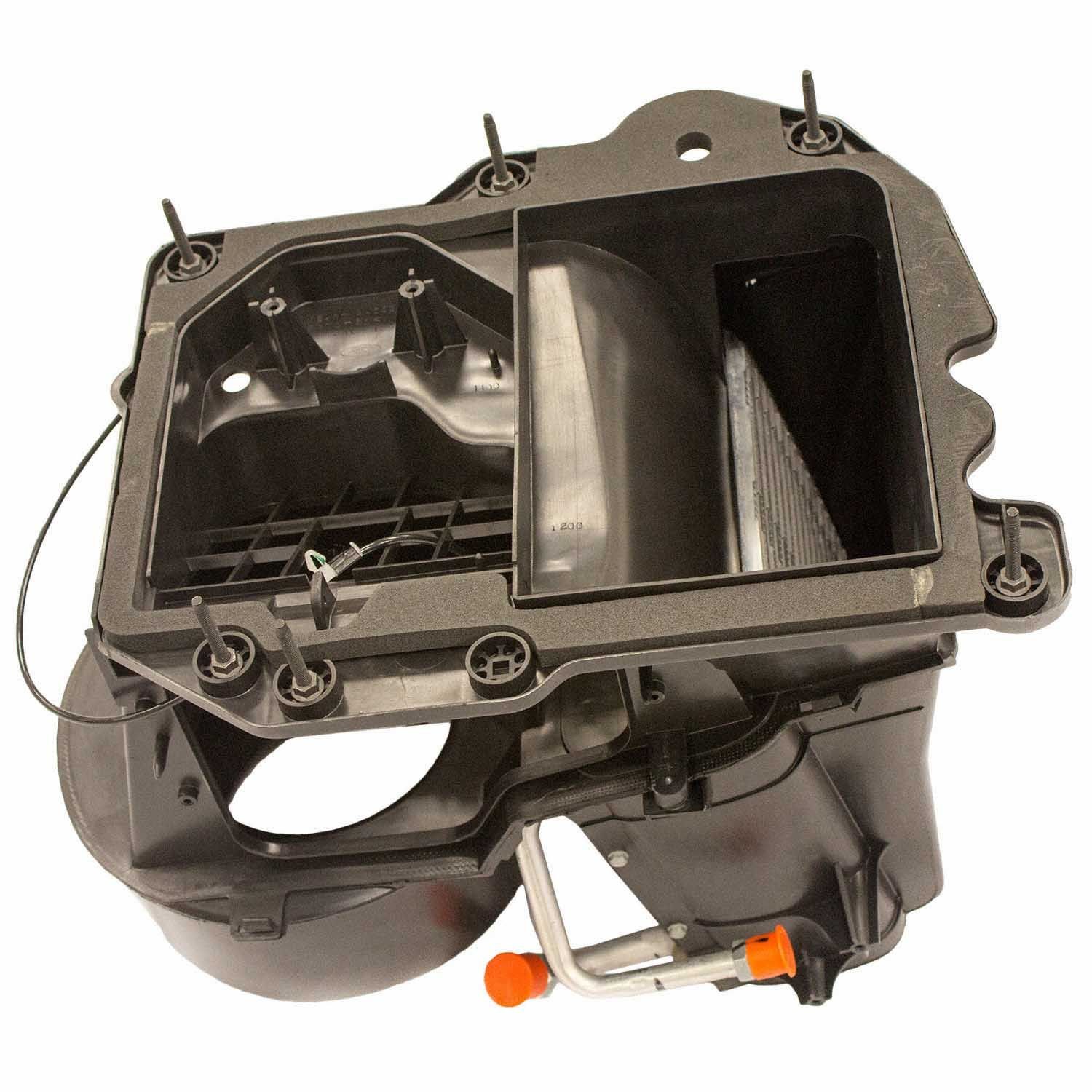

Lets try this:
https://www.onlinefordpartscatalog.c..._id=&page_url=
If AC2Z-19B555-A is the correct part then here is a pic of that case and I believe the nubs inside the 2 circles are the condenser drains.
https://www.ebay.com/itm/33482354404...hoCazMQAvD_BwE
Hopefully that is the correct part!

Nice try but that’s the top of the evaporator case The holes are attachment points for refrigerant line brackets.
The drain might be the big spout under the blower attachment.

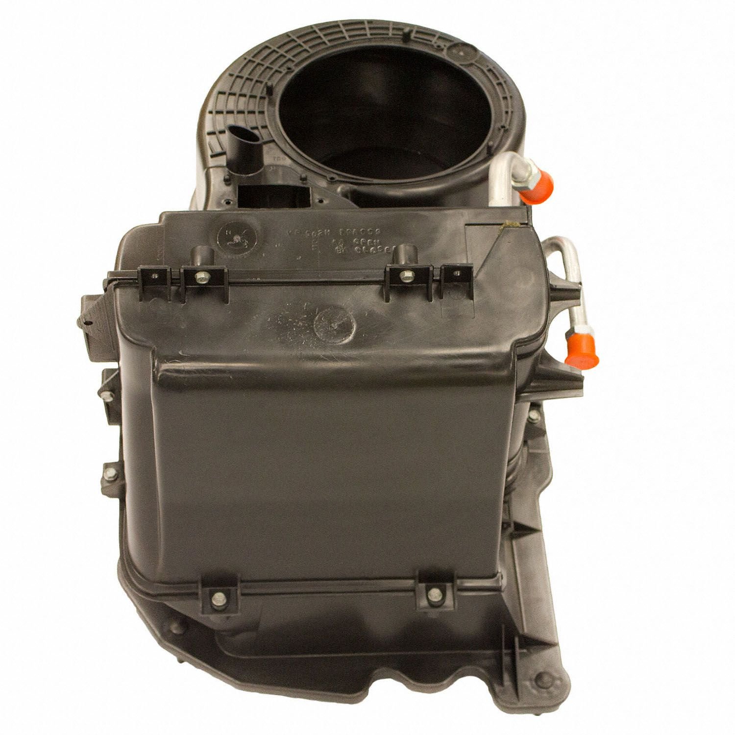

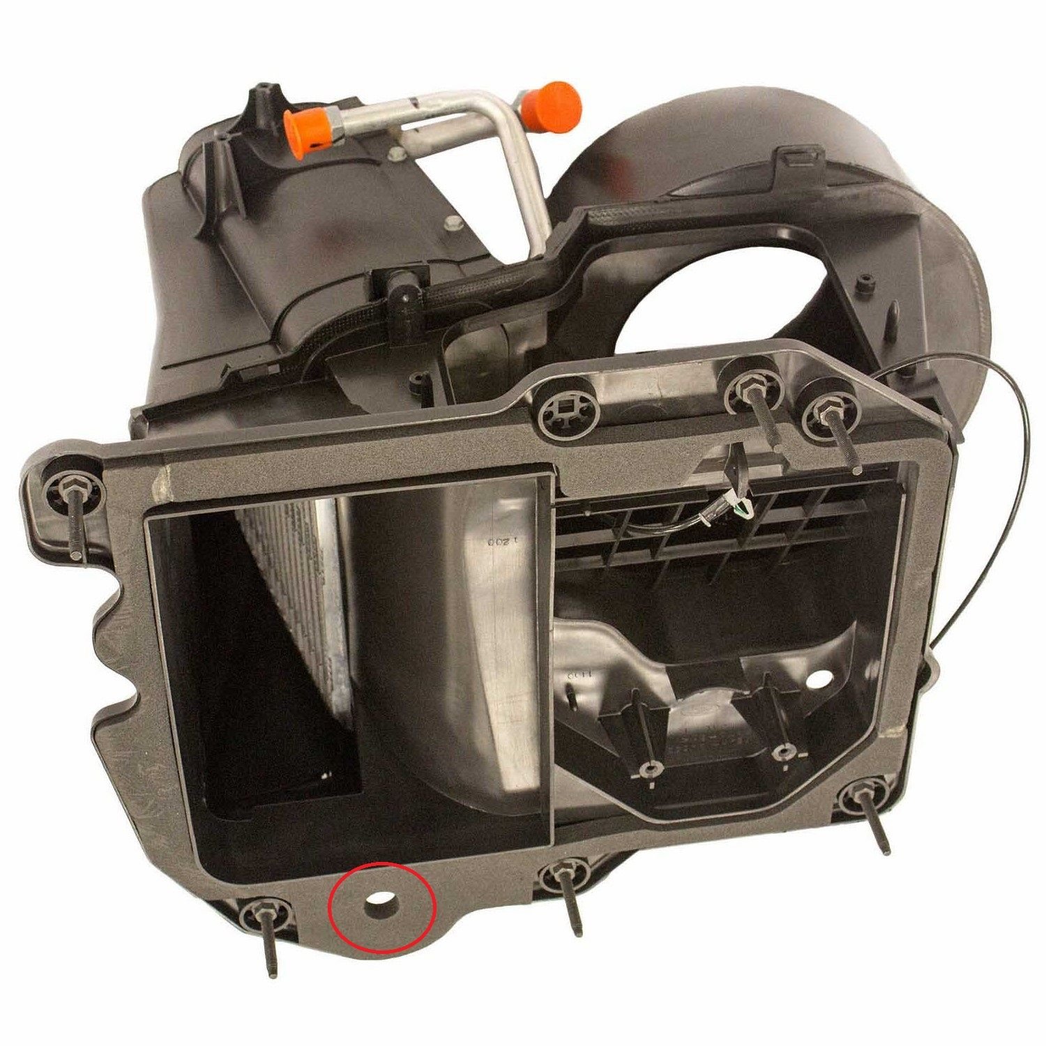

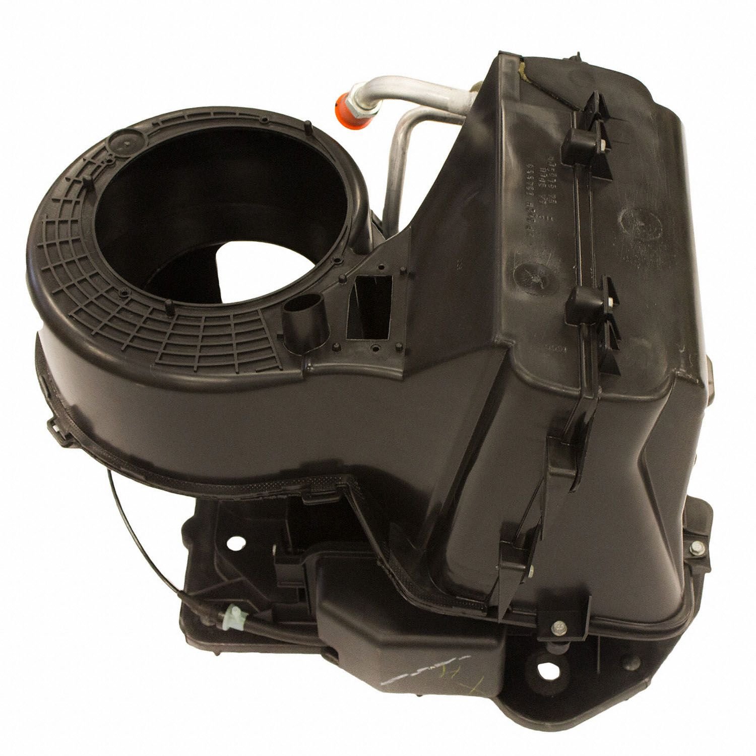

Ok Tabijan, that makes sense having the 4 support braces on the nubs that stick out. Well, lets try this then. The second pic should be the bottom of the case? In that second pic there is a hole in the bottom of the case. I know there is a huge difference in an 88 and this van but the drain on my 88 is actually built into the inner case and passes through the firewall and through a hole in the frame of the outer case. You can see it coming through the firewall the third from the bottom pic of my case van with the case off. The next to the last pic is my case. and the last pic shows the hole in the newer case
1988 outer evap case
Perhaps that is what this hole is for in the 2009 outer case?
