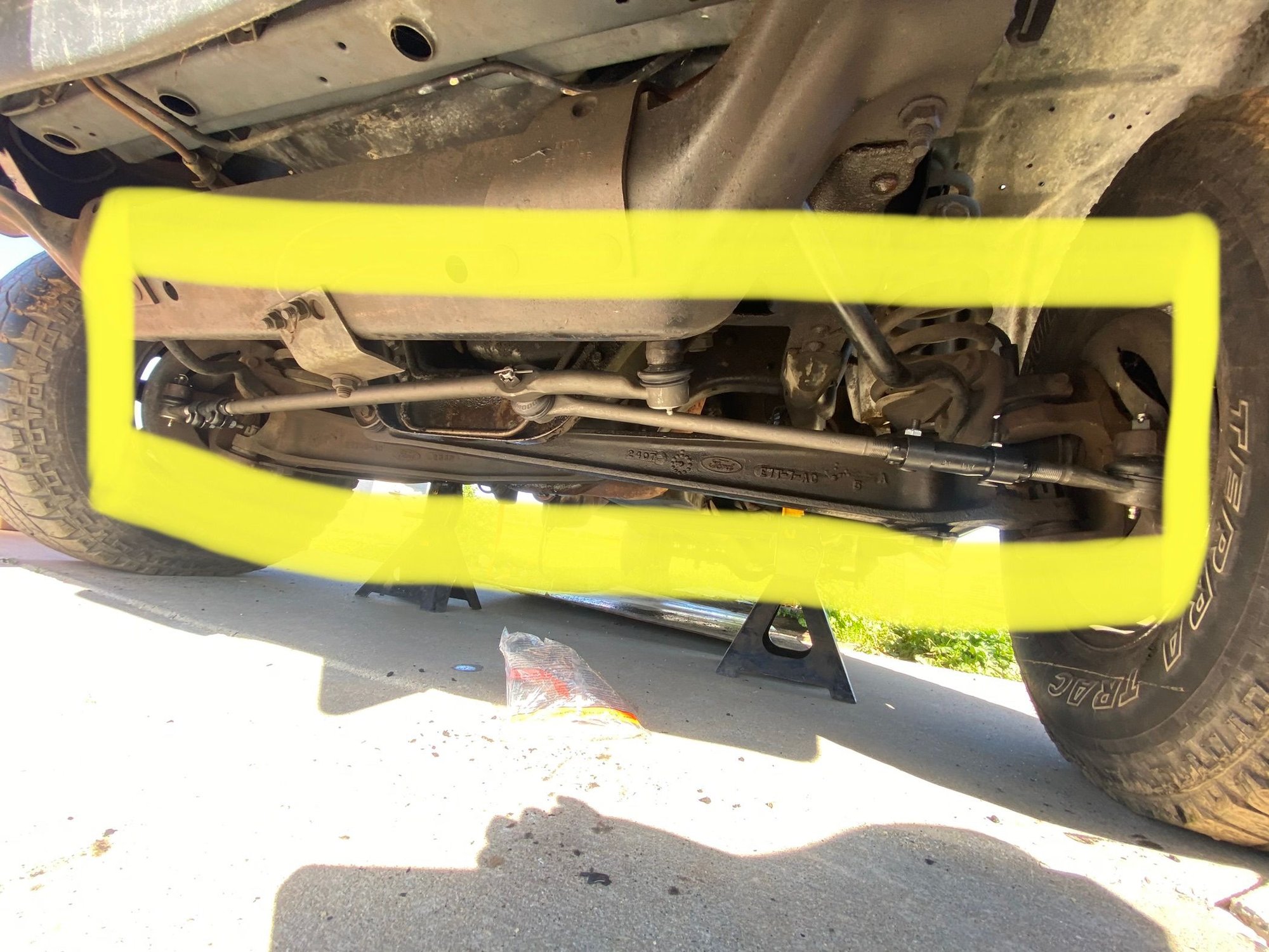

Originally Posted by machgirl03
OK. Yeah, I don't have a 2nd person here near me that can check it like that. I will ask around for a decent suspension shop and have them look over everything. Including u-joints etc.
these are the components, you can see that middle linkage, that’s what connects to the pitman arm which you can see it’s the one facing up. It’s fairly simple, you don’t have to know what you’re looking at, you’ll see one part moving and the other(s) not moving and where it stops moving you replace that component. Even if you can’t check it yourself this will give you an idea of what it is that the shop is gonna tell you
That shaft I said to turn is simple as well it’s what goes into the column it almost reaches the firewall.
This truck is a 1988 that I uploaded a picture of so it may be different but it probably didn’t change that much. From what I know at least.
