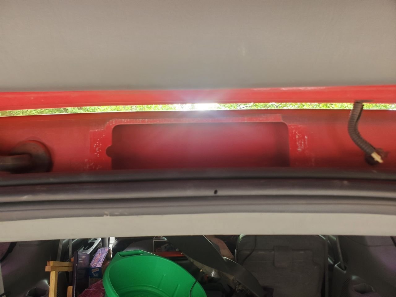

Look above the hatch opening.
there is a Vent there, or not.
My truck does not have a vent grill in the hole, it was wide open to the elements.
every time it rained, the entire back of the truck, and the inside of the rear AC compartment was soaking wet...
in lieu of the Vent, I use silver Duct Tape to seal up the hole.
that stopped the rain water from getting in the truck.
a forum member saw my problem, and had a spare vent, he graciously dug it out of his spare parts pile and mailed it to me. I gave him some chattel and all are happy

I do have the vent in there and I will definitely seal it up with some aluminum ducting tape and hopefully that'll help. Thanks for the input! Several parts of the weatherstripping are torn up, looks like the PO had a dog that bit/clawed at it.
Do you think that Ford used similar weatherstripping on the Lincoln or another SUV? The weatherstripping has a metal core for the channel that clips on to the pinch welds. Does anyone know if there is another similar style that I can use since this specific part doesn't exist anymore?
