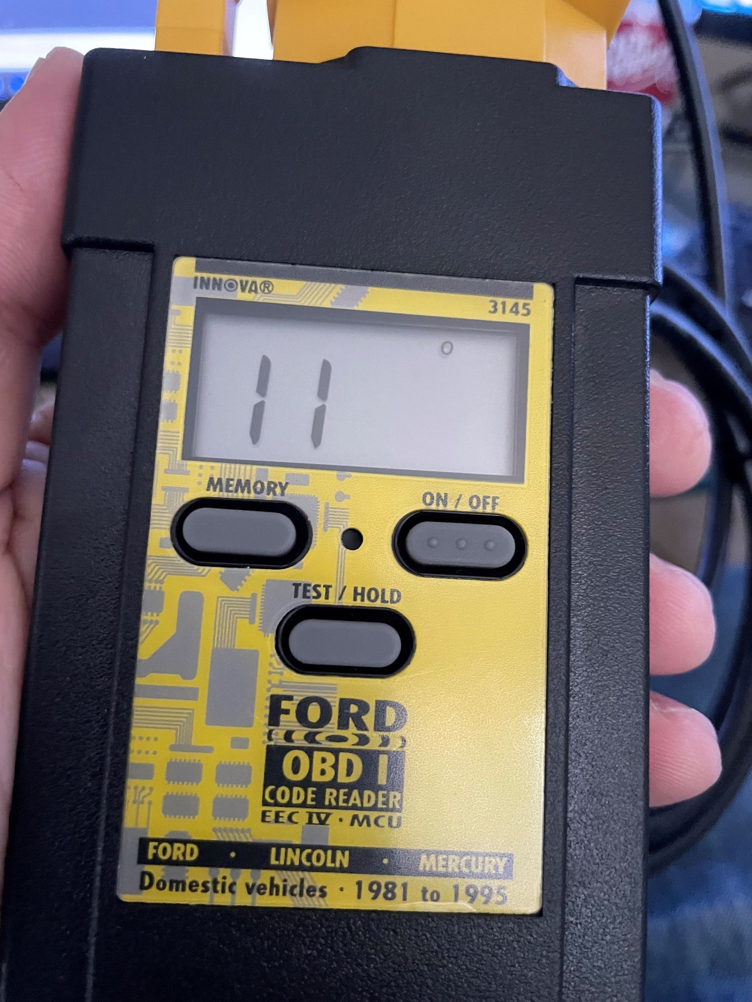

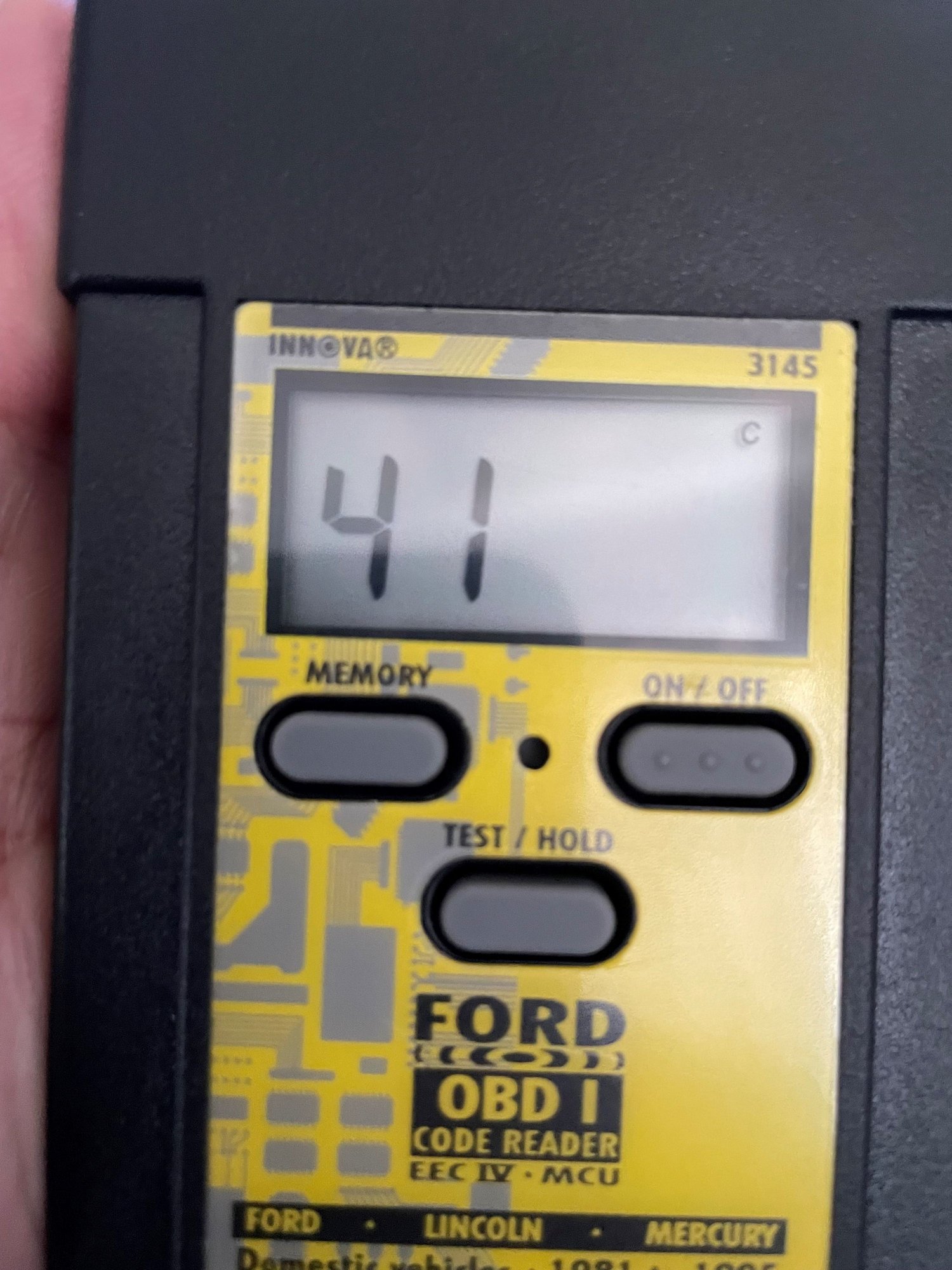

OK so fairly quickly here, drove the truck today to see my Dad and got a CEL. Pulled the in-memory codes and got another code 41. Only got up to 45MPH so no long hot highway driving to make this happen. Since one of the symptoms of a bad o2 sensor is a code 41, would it be prudent to start there? I know I can test it but even if it tests good it's likely original to the truck, so I don't really feel bad about just getting a new one and see how it goes. Even if it doesn't fix it, I can rule out the o2 sensor as being the code 41 cause and would know I now have a new o2. Is there some reason to preserve the original o2 as in its better than the ones made today for example as to make testing it something I should do? I plan on keeping this truck for as long as I can drive so putting new gear in it is OK by me even if it doesn't fix it.

Are you sure you're reading the codes correctly? You should have 3-digit codes for a 1993, not 2-digits.

He is using the Innova 3145 so there is no way he wouldn't know how many digits his uses. The born on date is what the truck is using for codes and not the model year as I understand.

I thought the same thing, 2 versus the expected 3 digit codes, but I have never seen a code reader misinterpret like that. I wonder if the truck has the original catch code PCM installed.

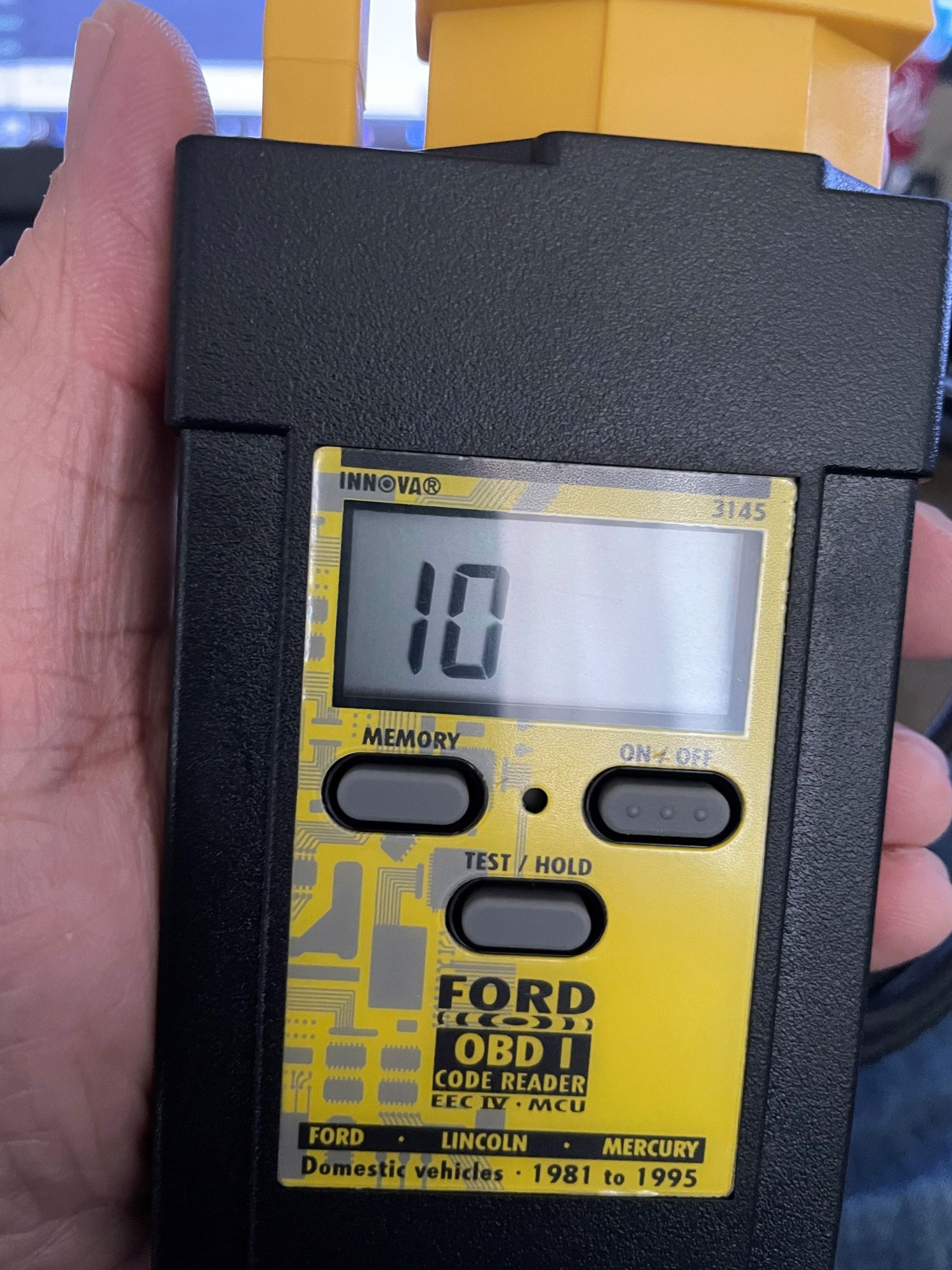

I have never seen anything on my reader but 2-digit codes. New to ODBI so to answer your question I am not sure at all I am reading the codes correctly. My Innova 3145 tester only ever shows two-digit codes. Even the Seperator codes are two digits.

All of my OBS Ford trucks were built in Canada. Those code Innova 3145 code readers are pretty good. It appears to be displaying the correct codes the computer is sending out. No worries something amiss with the reader.

So spent a little time on this. Code 41 seems to indicate possibly two different problems:
HO2S circuit indicates system lean (right HO2S)
No HO2S switch detected (right HO2S)
I am not sure which I am getting on my truck. Maybe a quirk with how OBDI works in that a code can have multiple meanings and you cannot be sure sometimes what code means what. I think @sandymane alluded to this referring to code 41 as being tricky to figure out.
Based on the above options I read this to mean either the o2 is not connected or malfunctioning, or option two, the o2 sensor is picking up a lean condition. Assuming I have that correct, how would one know which issue the computer is seeing? And with the lean option being true, would that point to perhaps the low fuel pressure @Prototypemech mentions earlier in this thread?
