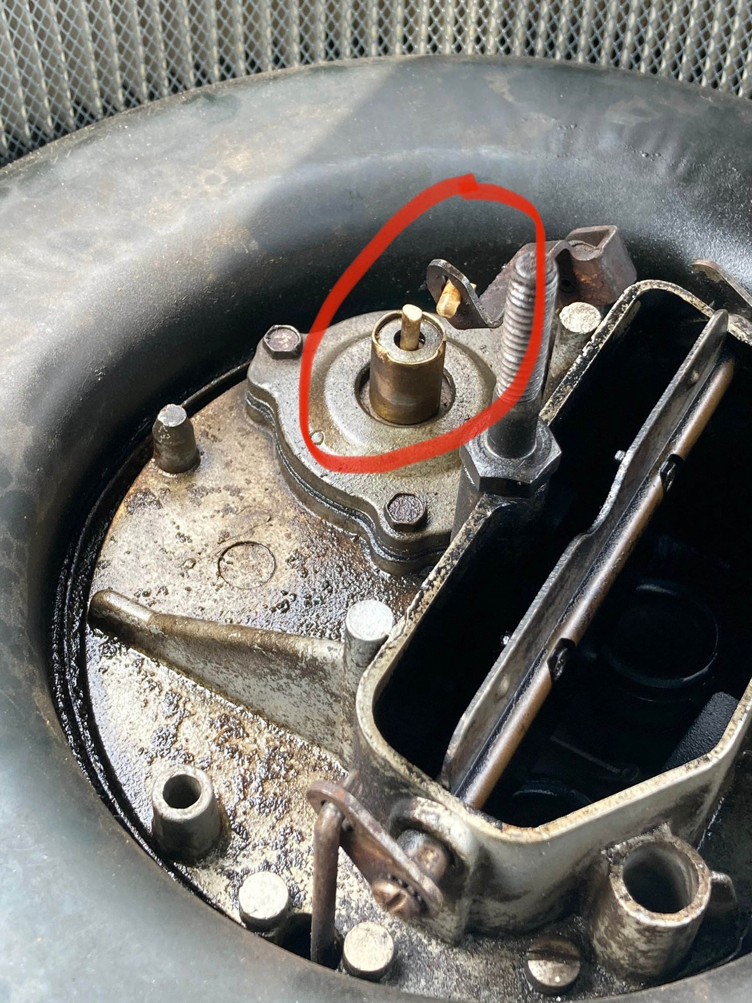

Hello- when doing a little maintenance I noticed this part of my carburetor appears to have broken. I am not sure what it is nor what needs to be fixed. Any help would be greatly appreciated. Thank you.( 1974 f250 2wd )

Its a "choke pull down" or "pull off" depending on who you ask.
It partially opens the choke when you first tart it to keep the engine from loading up or running too rich
New ones are supplied in a carburetor kit and you might be able to buy one separate from any parts store.

Don't count on a carb kit containing one of these. The last three kits I've used did not have them. I'd look for a separate piece.

Give these guys a call... they will set you up.
Mike's Carburetor Parts (carburetor-parts.com)
I am guessing it's a choke pull off from a 2100? If that's the case, then here ya go.
Motorcraft 2100 Choke Pull-off AP278 (carburetor-parts.com)
