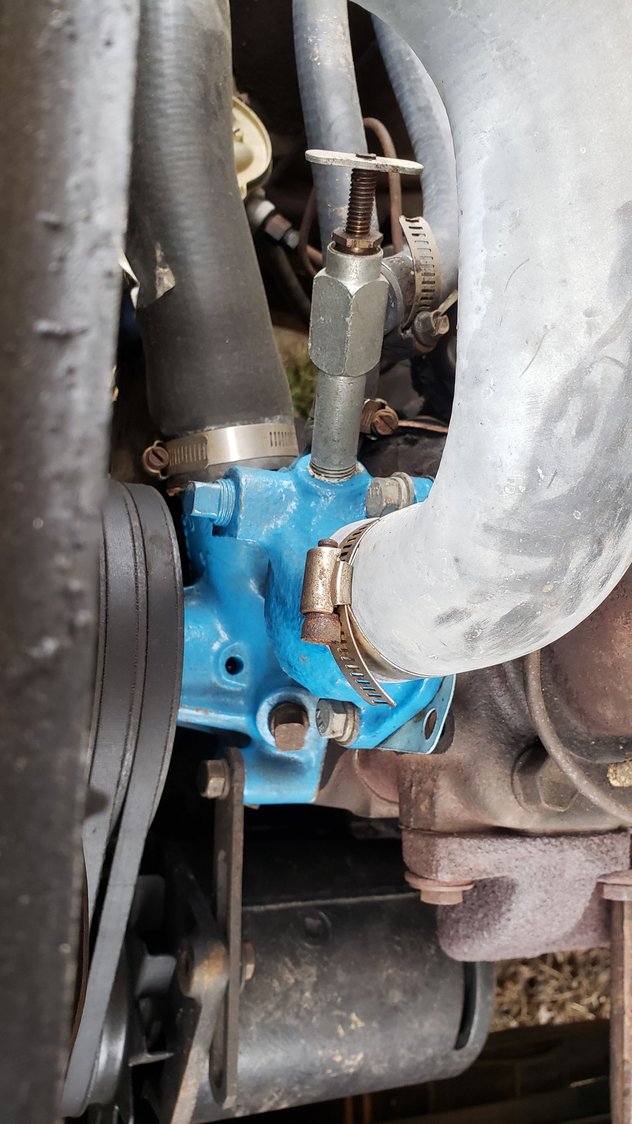

On my '62 with a carb to manifold heater block. The hose ran from the thermostat housing to the cab heater. Out the cab heater to the heater block. Then it went to the water pump.
You can install a valve that screws into the thermostat housing. Connect the hose that leads to the cab heater to the valve. Most auto parts stores should have the valve. I'll try to post a picture latter.
Tom

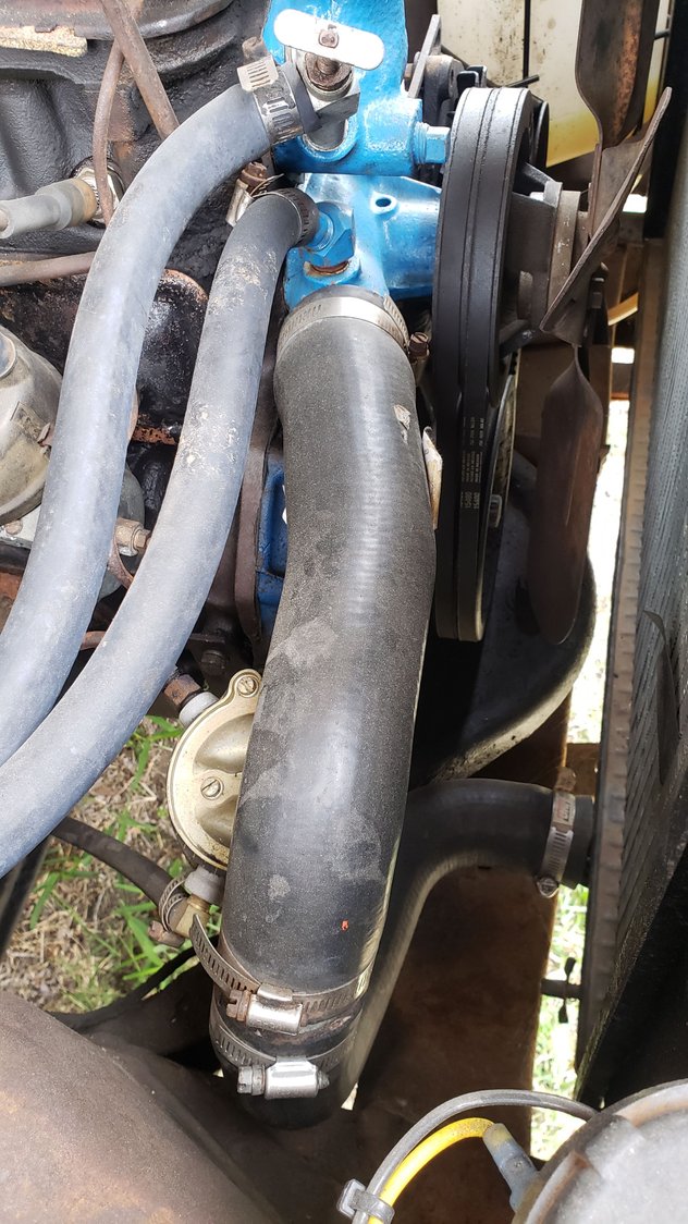

The valve was a Murray 84791.
I do not have the carb heater connected due to one hose end being too short to hold a hose. Block is still under carb. The return from the carb heater either went to the cab heater connector as shown in the 3rd picture or it went to a fitting where the pipe plug is that is shown in picture 1. I don't remember which.
And yes, that is a 2 piece hose I had to make up for my 262ci to get around the fuel pump.
Hope this helps to do your manifold.
Tom
