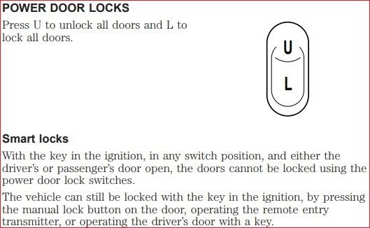

My door ajar light stays on but that wouldn't stop it from locking would it?
Looks like might. From a 2001 Mercury Grand Marquis book ... I'm sure it was same in 2002.
