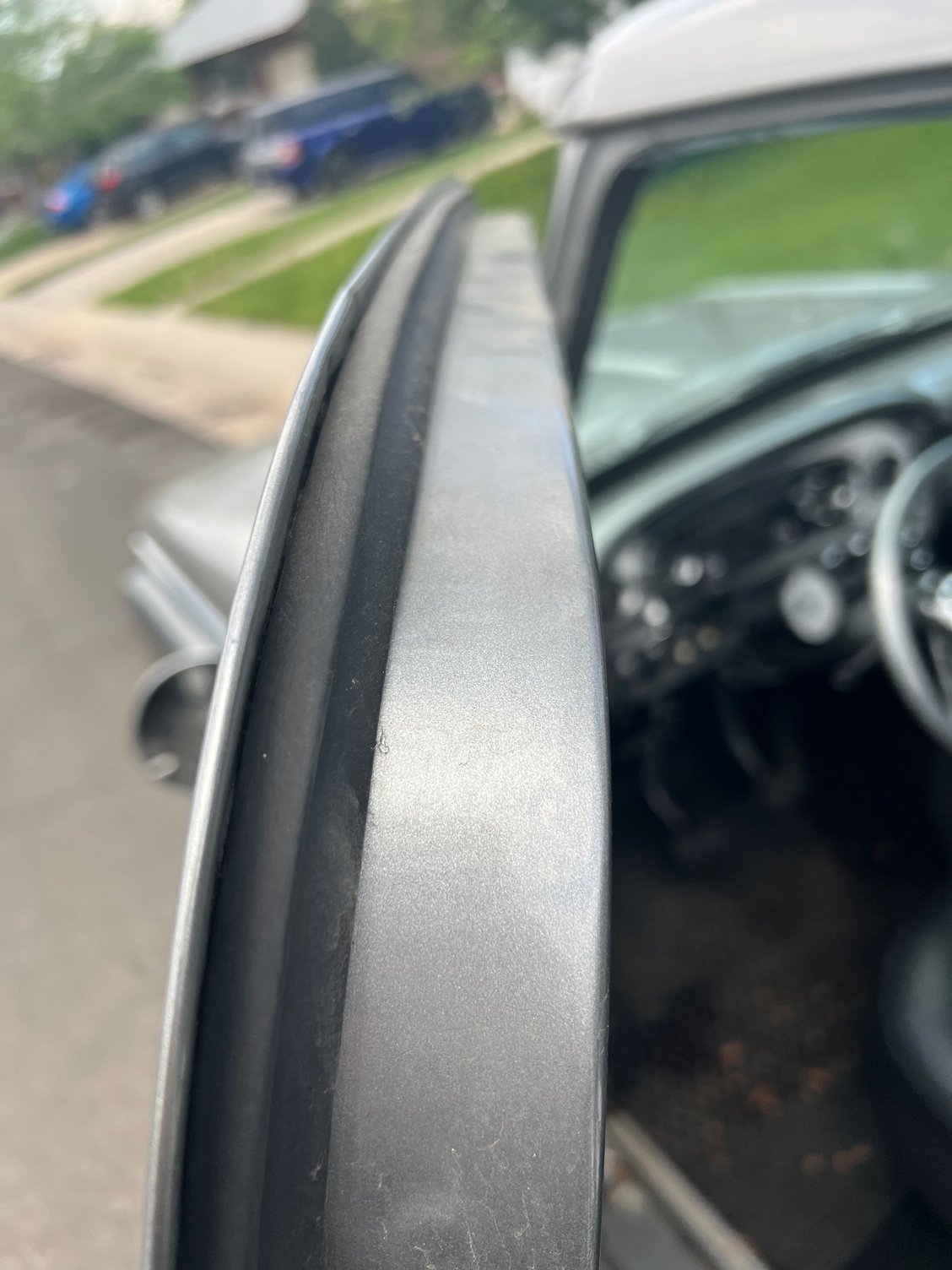

Does anyone have a vendor that sells door seals that fit our doors? The original one on mine doesn’t even touch the cab and the one I bought to replace it is the same size.

Dennis Carpenter

....adjust the door fit and gaps without the new or old seal in place. After you glue on the new rubber it should take time to compress and allow the door to close. I used a ratchet strap between each door to slowly compress the seal and close the doors.

+1 on adjusting the doors first, for proper gaps all the way around.
