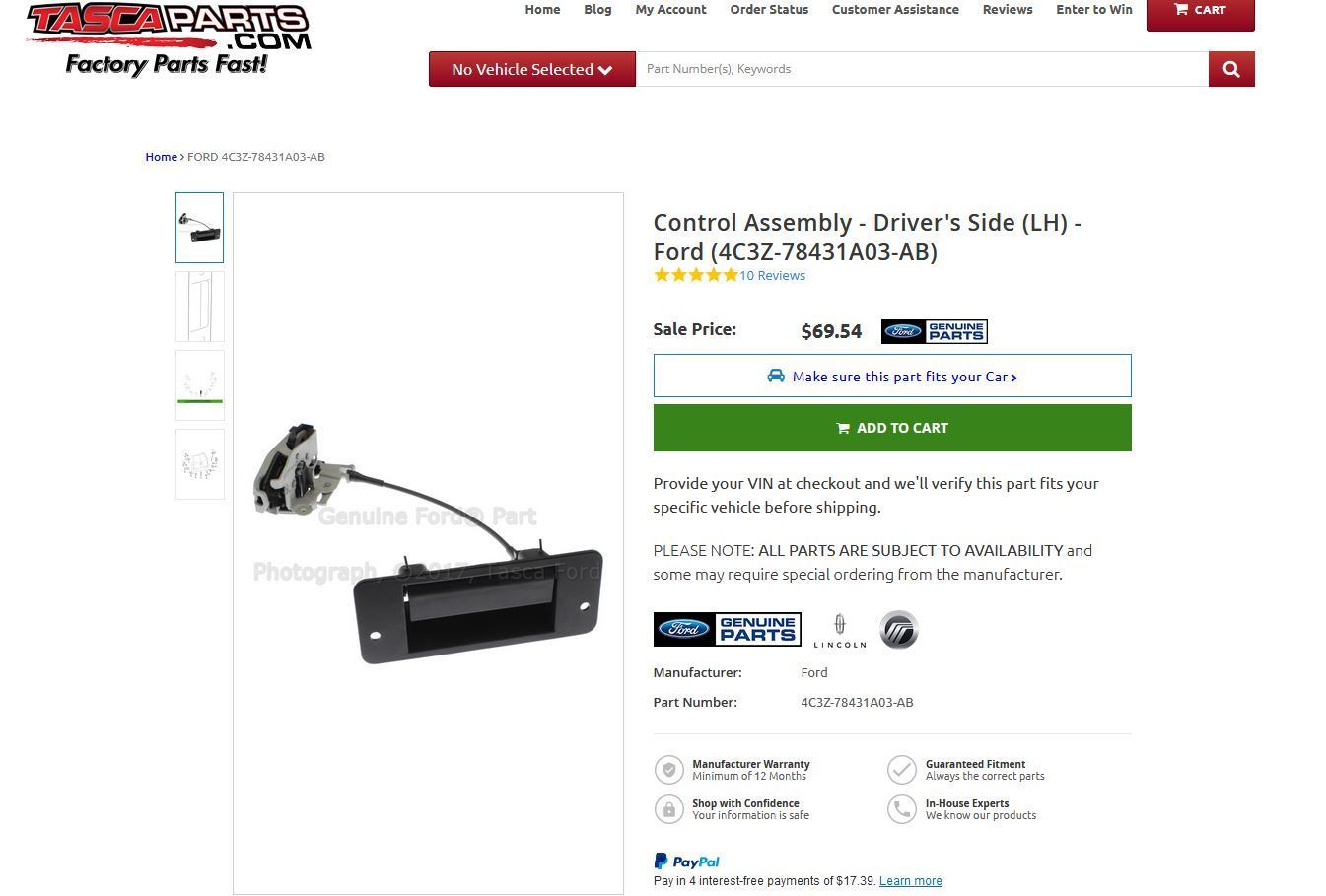

Anyone have a part number for this part, or rather the equivalent E-350 one that works.
I saw this video where a guy used an E-350 cable because the one for the Ex has been discontinued.
Any direction would be helpful.
Thanks.

Which barn door? The left door handle and cable are showing still avail.

Thanks 01_Excursion. Ordered it from The Ford Store on Amazon. Maybe, by ordering through Amazon, it will be the correct part.
I was looking for just the cable, but I might as well get the whole kit and be assured that the handle won’t break, as well.
Thanks again.

I got this part as well. Hardest part was drilling out the original rivets on the bottom of the old one. Got to be careful leveraging yourself against the fiberglass doors.

https://www.ebay.com/itm/22431691248...mis&media=COPY
This is the one I used to replace cable when I repaired mine- worked perfect

Just installed it last night. Yes, had to drill out two (2) aluminum rivets that held the handle in place and then replace with nuts and bolts. Clearance for the passenger side door was not a problem. The Torx 27 bolt on the bottom was a little tougher to loosen because they are secured from the factory with blue Locktite. Needed to push in pretty hard so I did not round off the screw head.
All in all, one of the easier projects.
Thanks 01_Excursion for the link.
