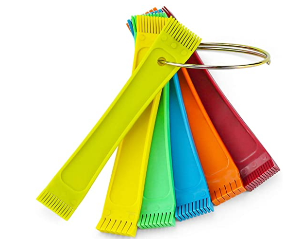

A set of radiator/fin combs will come in handy and they are cheap. I got this idea from Wes444 after he pulled a lot of debris out from his, as did I. I was able to straighten a few bird strike and large bug strike places too. I also cleaned up the power steering fluid cooler. I then used Simple Green and the foaming coil cleaner. That helped quite a bit when running down the road towing, but I figure as long as the fan is not acting erratically, it is doing what it was intended to do.

EDIT: Forgot to include a picture...

Thank you for the idea. Got to see if the local NAPA has them today while I have it out. Got the coil cleaner and Simple green.

So, just to clarify, you aren't actually using the comb on the radiator, or even the intercooler. You are using it on the AC condenser. That's the first thing in the cooling stack for manual transmissions, autos should have the transmission cooler in front of that I believe.
If the 1st thing has bent fins the air flow will be nearly completely blocked to everything behind that spot, some air will work it's way in behind the damage, but very little compared to straight fins. Be prepared to be surprised at how many sand pebbles you pull out. So do the whole thing. Pull the grille off for much easier access, and run the comb from top to bottom and work the fins straight. Expect to spend a few hours doing it, and a small thin flat bladed screwdriver will be a great help to the comb on bird strikes.
Once you are done go to a carwash, remove the grille and spray the condenser/atf cooler with degreaser. Then use the "high pressure" setting and blast it. Keep the water jet as close to straight on as possible and blast the wee out of it. Don't get off to the side or at an angle, you'll bend the fins over if there are split ones from fixing damage.
The light oil buildup from years of driving behind other vehicles kicking up oily rain spatter from the pavement will attract dust, which insulates the cooling fins, decreasing efficiency.
Don't use your manly pressure washer @ 4500psi at home, you'll bend the fins back over with true high pressure. Car washes use a higher volume of water at a safe pressure, they don't want to have to pay for removing trim and pin stripes from vehicles, so the pressure there is safe to blast point blank up into the grille
Remember you have 3 to 4 stacks of cooling systems to degrease, don't be shy about it. Blast it in deep and rinse well. If the motor isn't wet you didn't get the radiator rinsed
