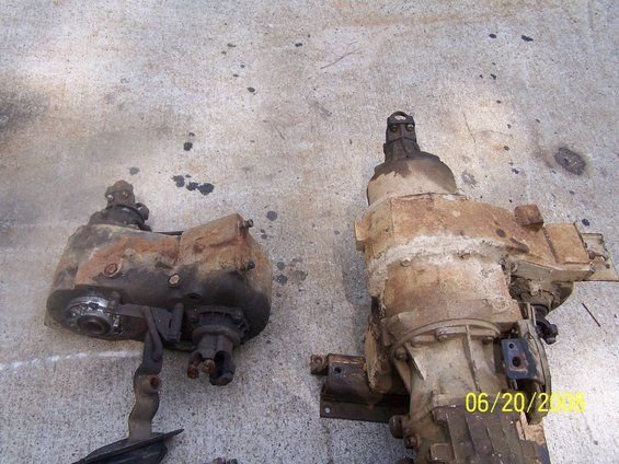

NP-205 w/C-6
Below NP-205 on left, NP-203 on right
Below 203 on left , 205 on right.
NP-205 on a NP-435 4 spd.
