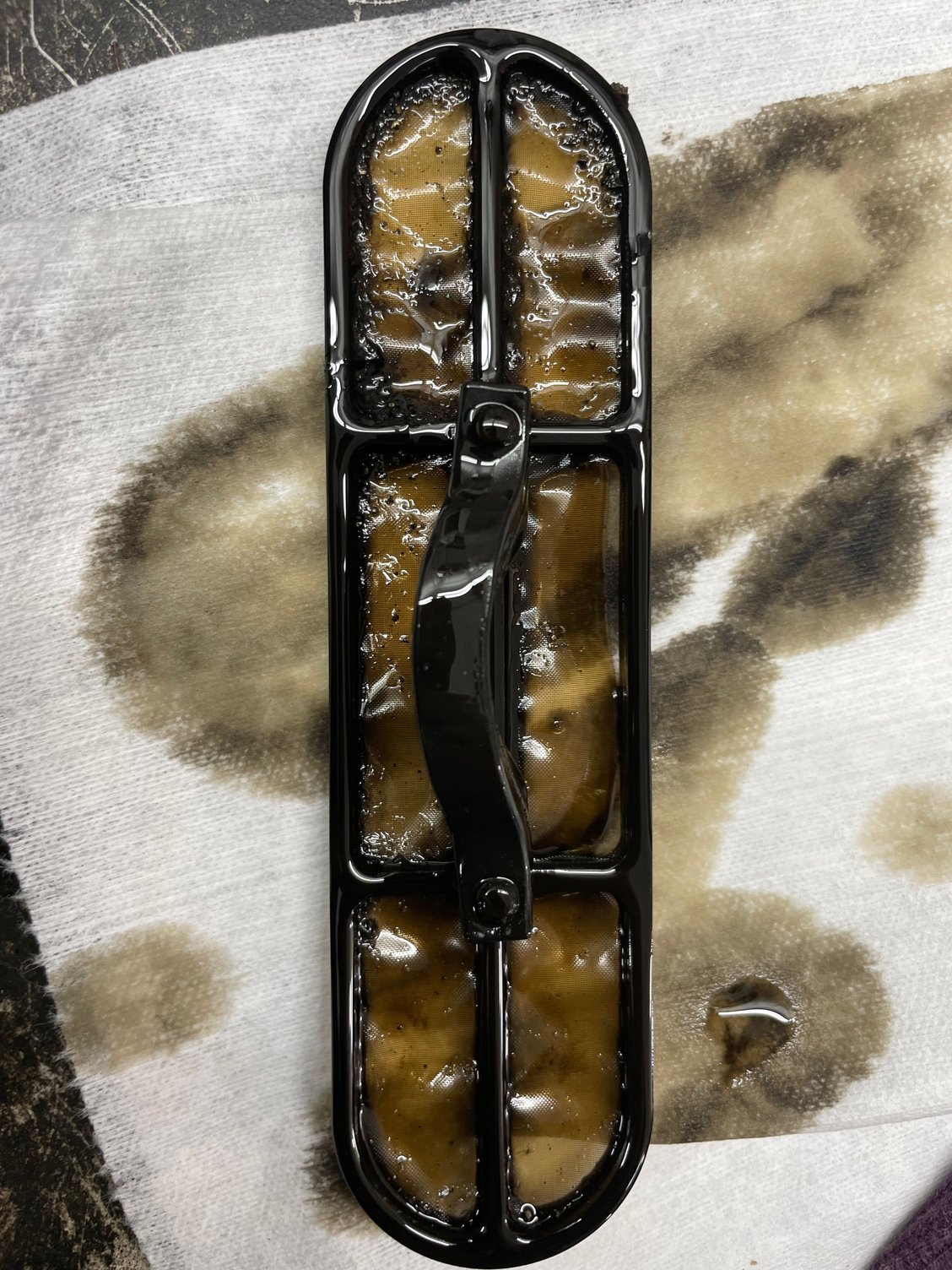

So being a 2003 engine with the log style oil rails I’m not too worried about the stand pipes/dummy plugs. I figure the HPOP is toast. So now I’ve started stripping it down and I noticed the LPOP cover looks like it’s been off. Should I be worried about the low pressure pump? I drained the oil and found no metal on the drain plug magnet other than a bit of fuzz. No more than my other 6.0s. When I removed the oil cooler the screen was slightly torn and pretty plugged up with crud and small pieces of what looks like brass to me.
Should I stop right here or keep going with my HPOP and oil cooler replacement? Any advice would be appreciated. Thanks

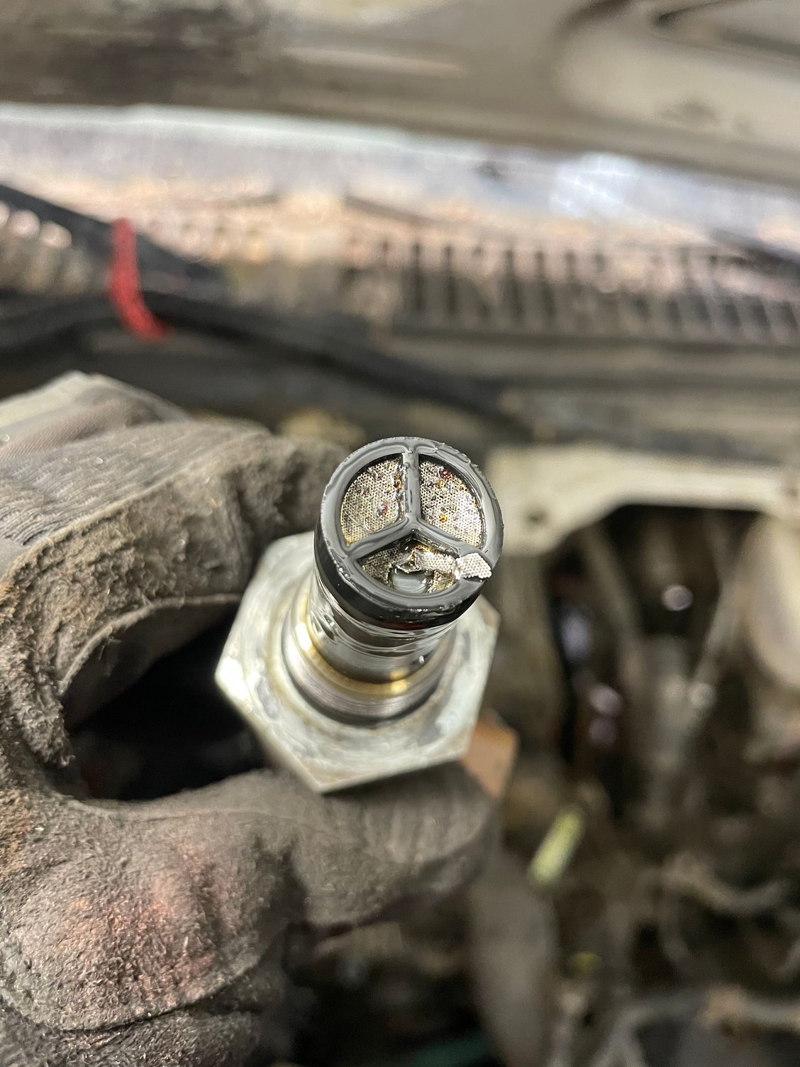

Post a pic of the IPR screen. See if it has the same brass particles stuck in it.
The HPOP is the most likely source of any brass particles.

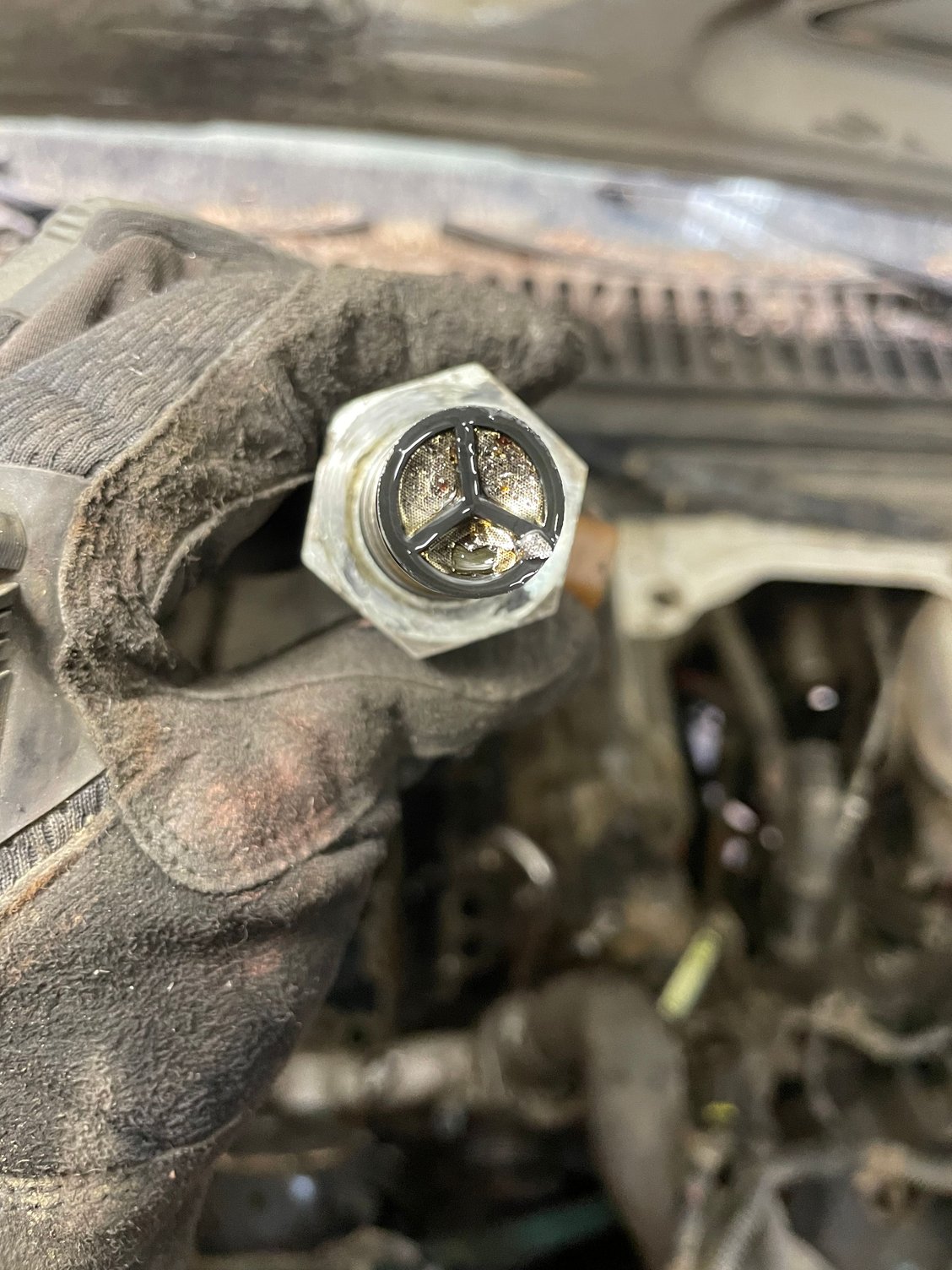

She’s pretty bad alright. I never got an actual PSI reading of the oil pressure while cranking. I wish I would of now

Look in the low pressure oil regulator also - for potential evidence of metal objects.
Unless you want to risk big bucks on an aftermarket oil cooler, be sure you go back in with an OEM oil cooler, purchased from a place that is KNOWN to supply OEM parts. The risk I mentioned is not about the aftermarket oil cooler, it is the engine risk. You probably do not want to spend big quite yet (a lot of "discovery" left to do).

The HPOP in-feed screen doesn't show the particles or damage like the IPR, so I'd say it ate the HPOP. You just need to check the LPOP for damage.
