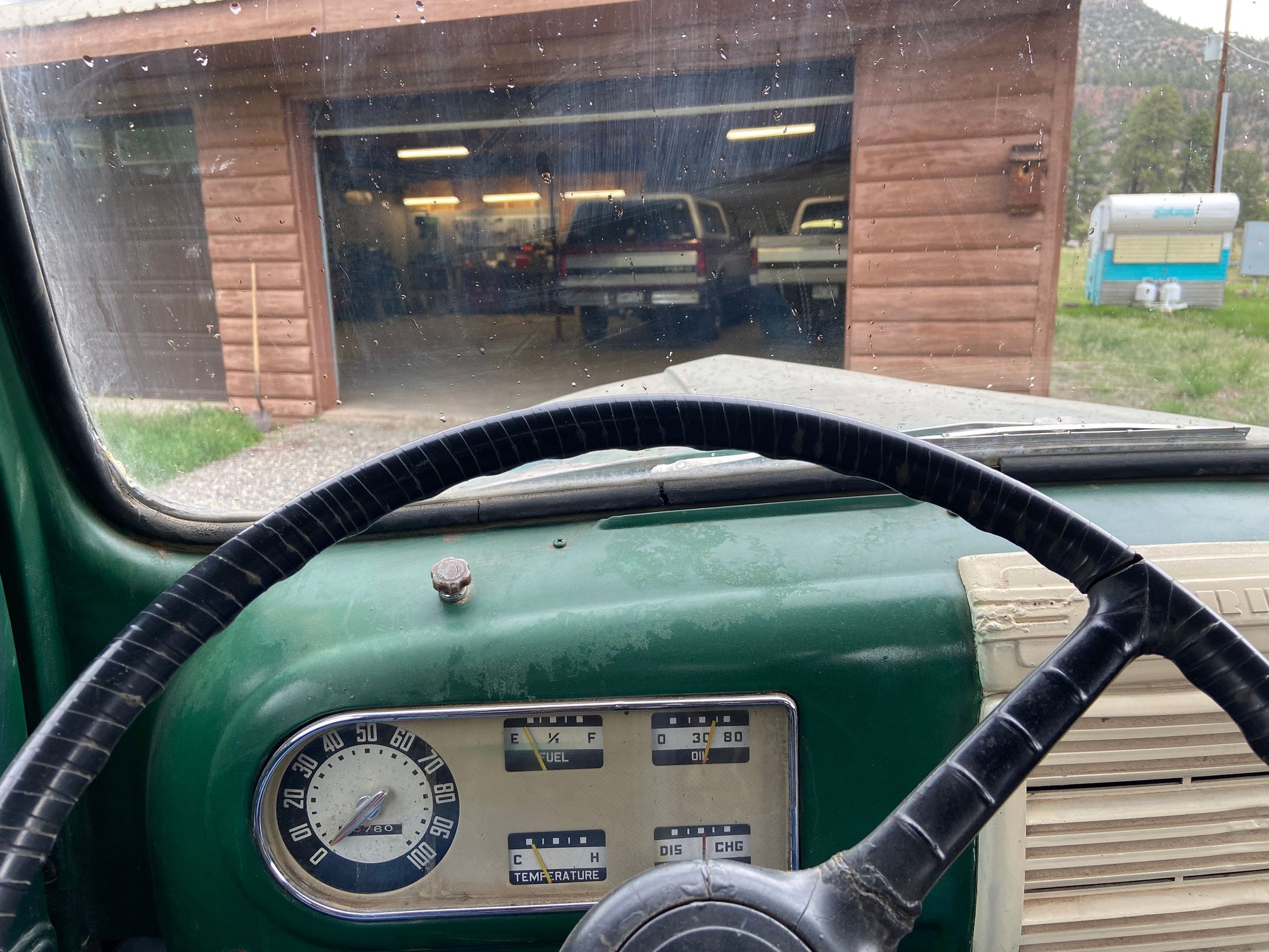

Thanks for the help.
Used the fitting to fill the carb, started right up. Removed the fuel bowl and installed a cork gasket, prefilled the bowl with a funnel.
Runs great. The fuel pump leaks a little so rebuilding that is next. I just like to take one step at a time so I know what I did or didn’t screw up. Got to take a little drive getting in just before a heavy downpour. We all know how well those vacuum wipers work.
