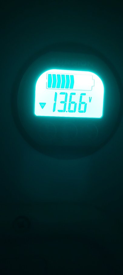

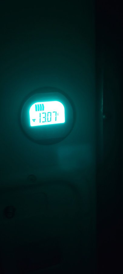

Start 8:30pm
End 5:30am
I ran a test..(no solar no truck voltage)
-Trailer not connected to truck
-Refrigerator brought up temperature
-Refrigerator left on highest setting
- Noted battery level 13.66v
-Removed shore power at dark 8:30pm
-Checked battery, before sunrise, 5:30am
- Noted battery level 13.07v
Thanks again for you information and time. I feel comfortable now about traveling with this 12v refrigerator

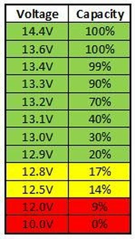

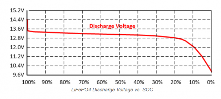

Here is an approximate voltage/state of charge chart that is specific to LiFePO4.
Guessing the state of charge based on voltage can be difficult. LiFePO4 has a fairly flat voltage across most of it's discharge curve. The below graph may not match exactly with each vendor's cells, but I'm showing it here so you can see how flat the voltage can be from 90% to 20% state of charge.
A quality LiFePO4 battery should have a BMS that will cut off the discharge at a certain voltage. This should prevent the situation where the 12 volt refrigerator drains the batteries to zero. In my trailer I have the 12 volt circuit to the trailer's main distribution panel set to cut off at 12.0 volts. The BMS is set for a lower value than that so I can still power critical items that aren't on the trailer's main distribution panel. The inverter has a similar low voltage cutoff (~12.0 volts). The BMS should be the last line of defense.
thanks for the detailed info, I'll keep graph on my ph
