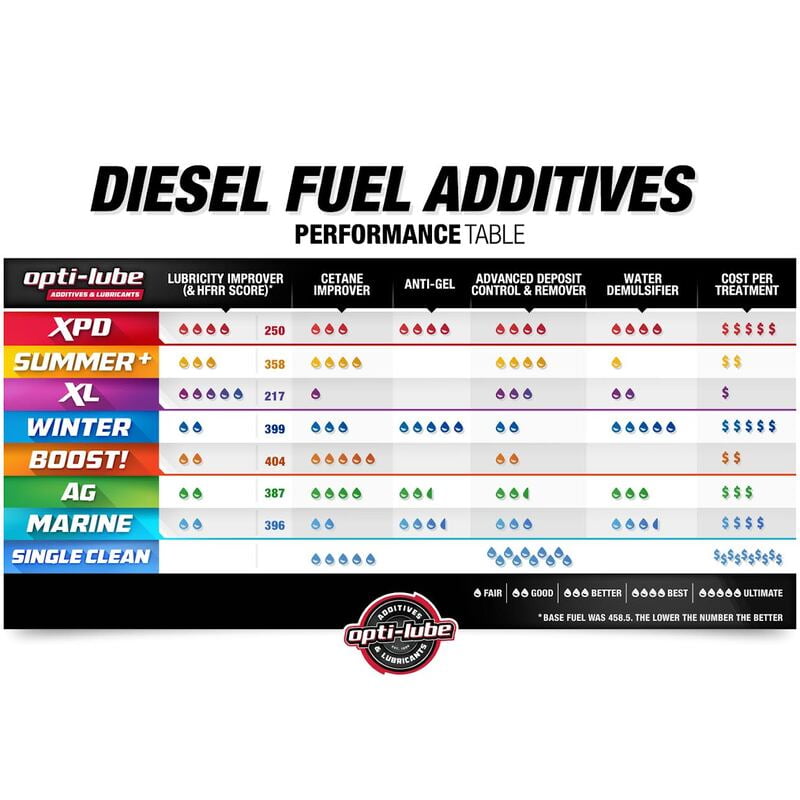

As for additives, I have been a long time Hot Shot's EDT user (except for that 5k mile Archoil AR6500 trial... which was worse, I'd stick to Hot Shots!) however, I recently switched to OptiLube XL since I am exclusively using R99. Renewable diesel has a 70+ cetane rating, so there is no need to boost cetane levels, and it is a cleaner burning fuel, so a lot of the extra additives that clean the fuel system shouldn't be needed. However, Renewable does lack in lubricity, so lubrication is needed! Hot Shots will work fine for this, but it is also needlessly boosting the cetane level (possibly too high as there is such a thing) and all the extra cleaners aren't necessarily needed. This is where the XL comes in... it excels beyond Hot Shot's (and likely any other additive) for lubrication, and still adds a tiny bump to cetane, as well as cleaners. I figure this the XL is a great fit for those of us using Renewable exclusively....
