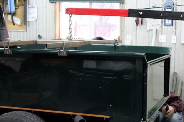

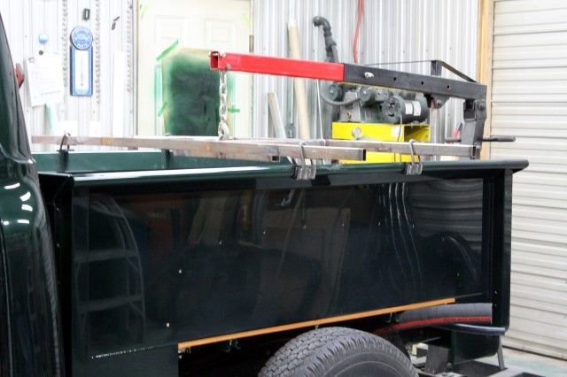

I work alone so have to figure a way to do things and use what I have and came up with this..bed was completely assembled other than the fenders but they could have easily been attached to the box as well..
