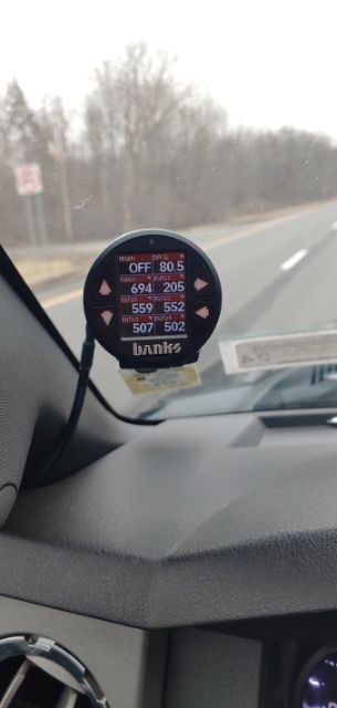

This is what my screen looks like, not using the truck today so just ran out and got this pic on a cold start. I have yet to see what the temps do during a regen. It seems like 1/3 is the only one that could be indicative of passive regen. 1/5 is usually in the 400’s when driving. Under the truck I can still only see 4, I’m thinking maybe they added one pre turbo? Egt 1/1 and egr 1/1 are very close if I compare them but egr 1/1 is still a bit higher. And there is indeed an extra fuel injector in the exhaust

Thanks... yeah you're not kidding... interesting... I would think, and I'm not an expert, the pre turbo sensor makes sense. The exhaust is already covered with the four that are there....

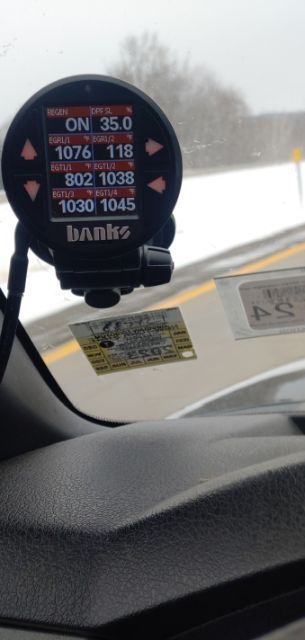

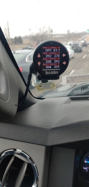

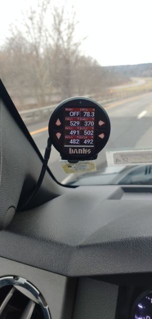

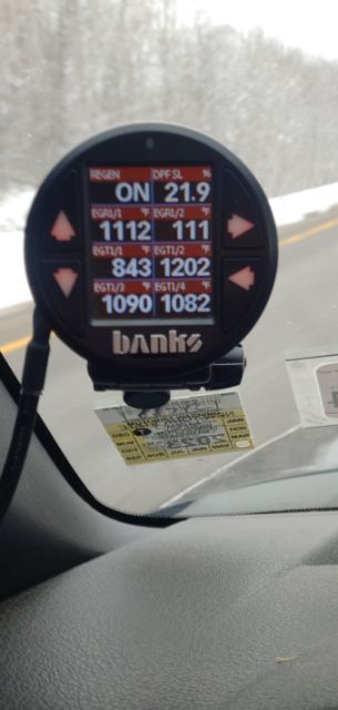

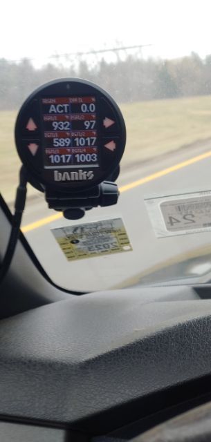

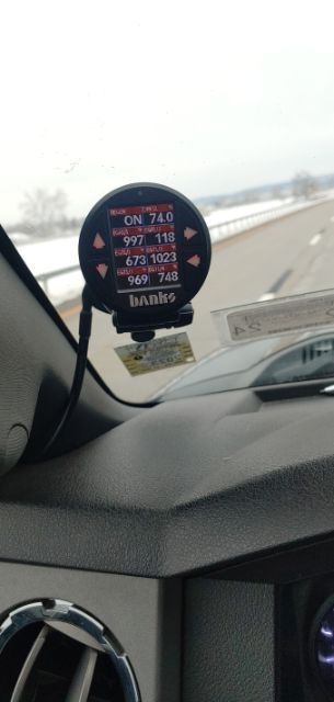

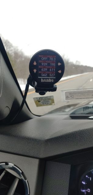

These are pics from January of this year when I did an active regen...
Pre regen
warming up....
SL dropping a little
Heading up in altitude... snow on the ground.
Small passive regening... prior to going active. I'm climbing hills...
Going hot...
Heading back north out of the snow... the expressway ends so I always turn around and come back. Temps usually cool off some then because it heads downhill going north...
This was a 23 mile regen that was 454 miles out from the last regen...
The iDash does not always go to zero during active regen, but will drop down to zero slowly after it's off. Truck said FULL, then went to 45%. The next day the dash said 40%. I've never seen mine go to zero, the truck that is, but have seen 15% on the dash. It varies... I think it does good for a daily driver with no load.
