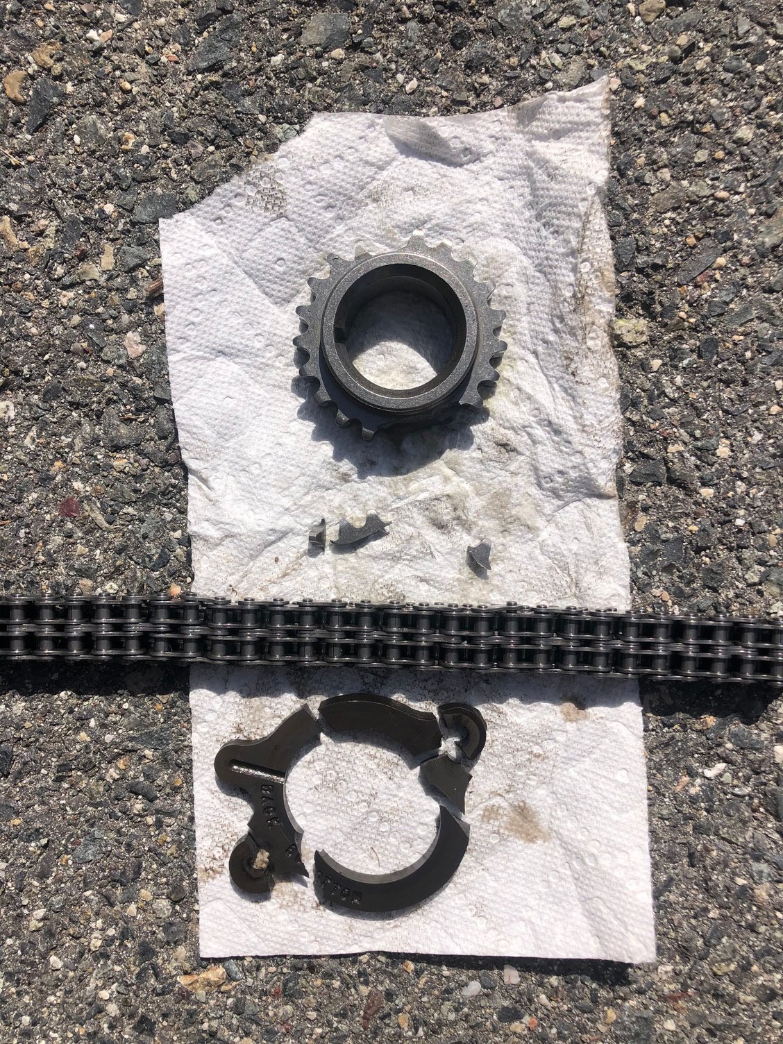

If anyone is curious about what carnage this dumb action caused, see photo:
Teeth missing from crank sprocket, cam thrust plate obliterated, and if you zoom in you can see two links of the chain really bent too.
I had already ordered a new timing set. An AutoZone about an hour from me has the camshaft thrust plate, and I'm heading out there now.

Yeah, looks like you found your problem! Hopefully that's all that got hurt.
yep all in the process of learning, been there before. And as for learning, i learned something today myself

Maybe I'm missing something, but it looks like the cam sprocket is on backwards also (or I'm so blind I don't see the alignment dot).
That is exactly what happened, he is replacing it all again now
