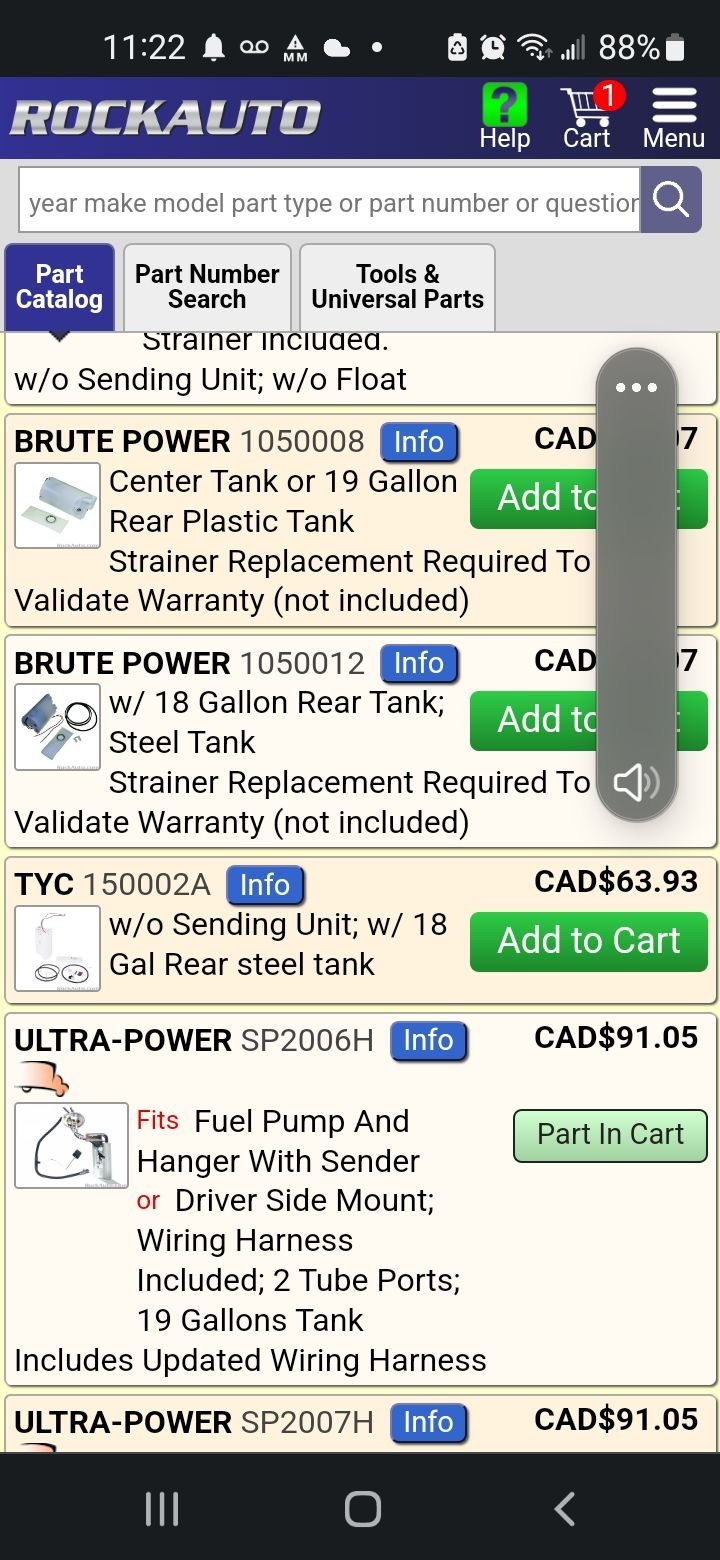

Diagram of a Fuel Delivery Module and theory:
So this what I need? Do you think i would be ok getting the ultra pro? Then i could put new pump assemblys in both tanks for the price of 1 Delphi.

When replacing just the pump it is a crap shoot whether the crossflow issue will be resolved. If the faulty valve is the shuttle valve the only way to fix the problem is a complete fuel delivery module since that part is not available separately. If you do go the aftermarket pump only route make darn sure the each of them have the check valve on the output side.

I can't afford it but I guess I will just put it on my credit card. I'm just going to get new Delphi FDM for each tank. I have to drop the rear anyway because the seal is leaking and the pump sounds loud. Hopefully I will never have to worry about this again. My luck has been terrible lately. I have a car too and it's been non stop . Fix one then drop off the other one to get fixed. I really need a break from this.
