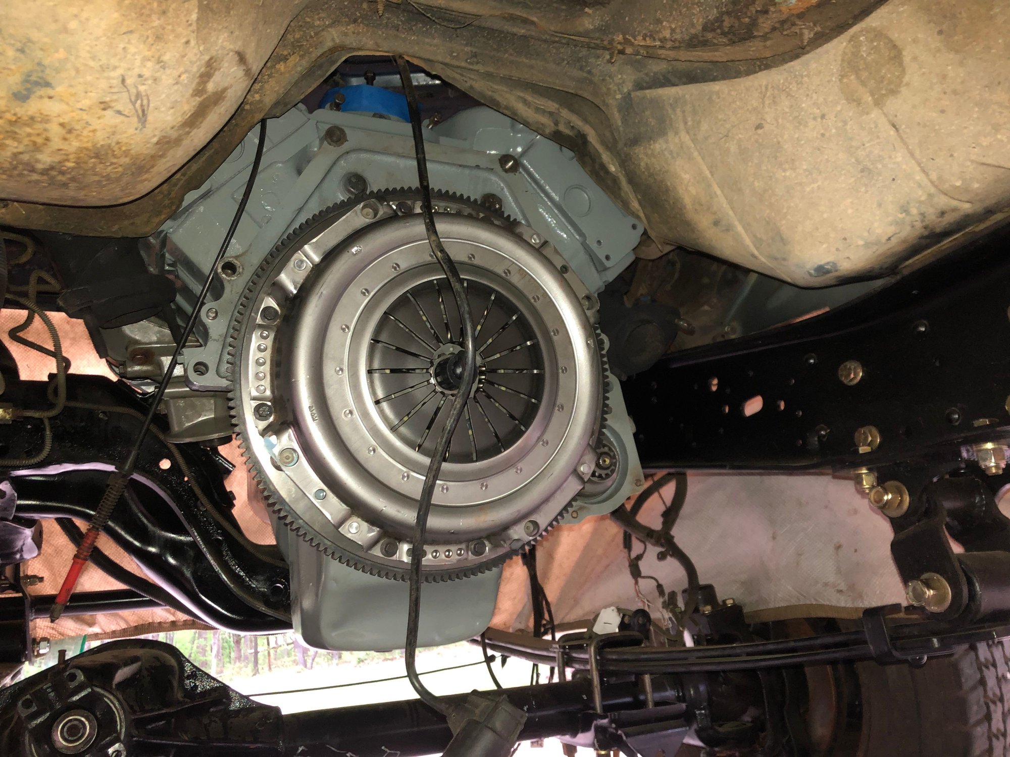

Hey guys, I’m doing a zf5 swap on a 94 460.
I am at the point where I am ready to install my new flywheel, clutch and pressure plate. I got no info for torque specs on bolts. Any help would be appreciated
Flywheel specs… and should I use loctite?
and pressure plate bolts.
I would also want bell housing bolt torque requirements, but I’m not as worried about them since it is metal on metal.
Let me know, thanks

As far as I can tell the inch and ft lbs are correct but not sure because of the wording. The master cylinder nuts are in inch lbs. You can get a Haynes Manual at most big box part stores. It might be very helpful for the installation information. Worth the price for the book.
Pressure plate 10 inch 15-20 Ft.lbs
11 inch 20-29
12 inch 15-20
Clutch housing to trans 40-50 ft lbs
clutch master cylinder nuts ZF 89-124 inch lbs.
concentricSlave cylinder bolts 15-20 ft lbs
cross shaft to lever nut 50-70
Pedal to cross shaft nut 50-70
clutch release bearing travel for 7.5 .0425 inch for external slave cylinders Concentric slave cylinders .0425 inch

I just did the job this weekend, but using a Luk flywheel/clutch/pressure plate on a 7.3 IDI with 3/8" coarse thread bolts.
Yours should be 7/16" with a max torque of 85 ft/lbs.

Yep, mine are 7/16-14 bolts. I will torque to 80-ish. What did you torque your pressure plate to? I just don’t want to go through the pain of dropping this tranny again haha. I dropped my first 2 trans for this project. Definitley a learning experience!
and mine is also a luk clutch and pressure plate. I had my flywheel respun as it wasn’t bad shape.

They should be fine thread, 7/16" - 20. 7/16" - 14 is coarse. Torque values are different. https://www.almabolt.com/pages/catal...ningtorque.htm
I torqued my flywheel to 45 ft/lbs, but big difference between 3/8 coarse and 7/16 fine.

It's been a while since I've put a flywheel or pressure plate on a 460 but I really think these should be fine 7/16 - 20.
I would really, really steer clear of hardware store stuff here, too, especially on something critical like a flywheel bolt. Not only do you need the strength of a quality bolt, but you also need to get the length right -- if your bolts are too long, they may hit the block after passing through the crank flange. Too short and you're losing strength. Top quality ARP bolts are $20 from Summit https://www.summitracing.com/parts/a...2802/make/ford
At the very least, I'd go to the nearest O'Reilly's or AutoZone and get Dorman flywheel bolts - should be $6 or $7 for a set.

Oops, I am retaded, you are right. I am thinking of my bellhousing bolts🤦🏽‍♂️. I have proper flywheel bolts which are intact 7/16-20. My bad. Sorry for that.

Ok. I may have missed it, but did you ever say what you torqued your pressure plate bolts to? I think mine are 5/16. 8 bolts. Not sure if that is the same for an idi or not.
