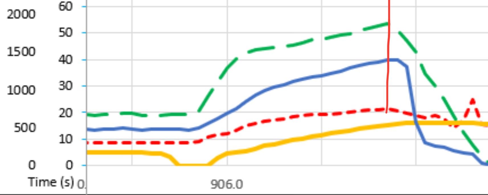

Like cleatus12r said, this data looks normal to me. Did it stall on you or have any other issue we can look for? If not, keep logging with each drive, and when the issue happens again, save that file and we'll take a look.

Yep. The very end was when it died. Just an estimate on the lines here but I left a stop sign right in front of my house around row 79500 and then at 79778 it died all on its own. I was in drive and accelerating. Put in neutral, coasted to my house, parked, and pressed stop on data.

Ok, here is the section from stop sign to stall. Looks like ICP drops, and MFDES asks for more and FUELPW increases, but RPM keeps dropping.
Did it start again?

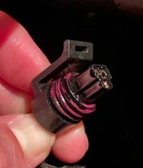

Is the ICP sensor original? Unplug the pigtail and see if there is oil in the connection. See if it will start with the ICP unplugged.

Ok, that ICP is suspect, given the connector oil, and your symptoms. Recommend unplugging it, and driving with ICP unplugged. The PCM will use a default values for ICP. If the rig does not stall, the ICP sensor is likely the culprit.
We recommend replacing it with a motorcraft part from a reputable seller, due to fakes out there. With that oil leak, I'd say get one on the way and eliminate that variable. Riffraff diesel performance and Dieselorings are good sources.

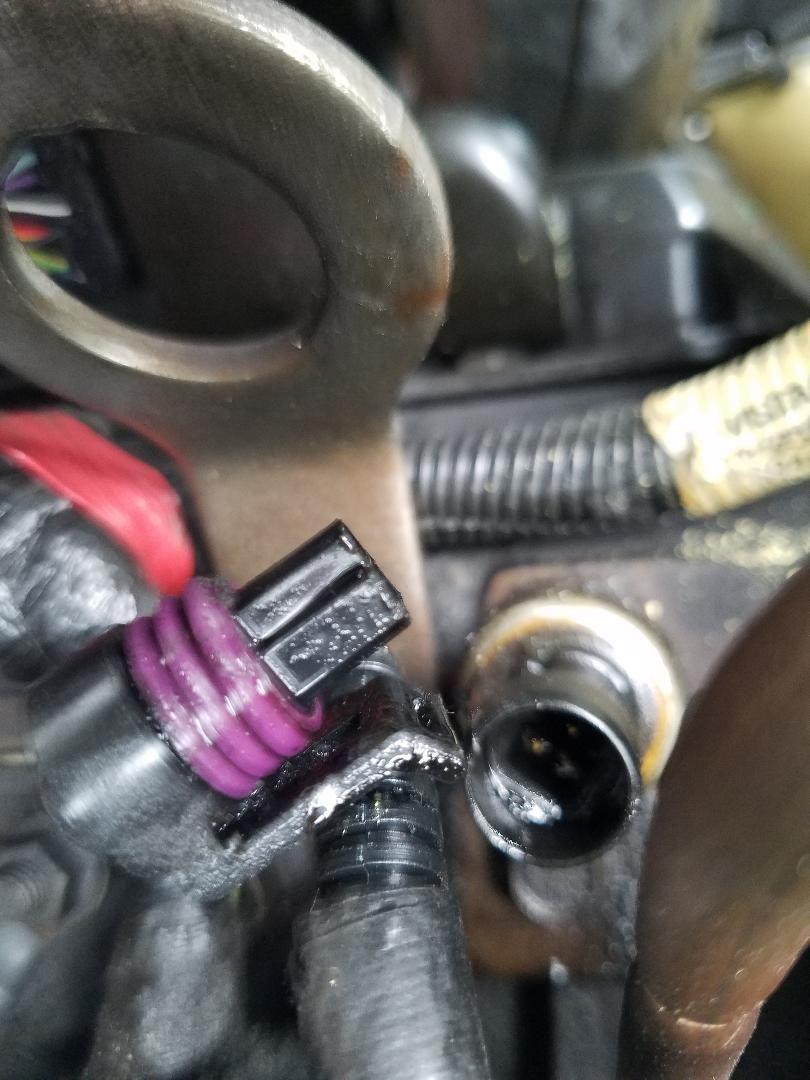

My phone really did not want to take good photos with no lights outside so this was the best I could get tonight. As you can see, there is oil on the rubber part and also pretty much the entire part beyond the rubber. I can do the test tomorrow to see if that improves the situation by disconnecting it.

That's a great pic - if that's not the problem, it's certainly headed that way.

Unless there’s some sampling delay or such, it appears the rpm starts to drop before ICP falls. Could this be as simple as a failing CPS?
