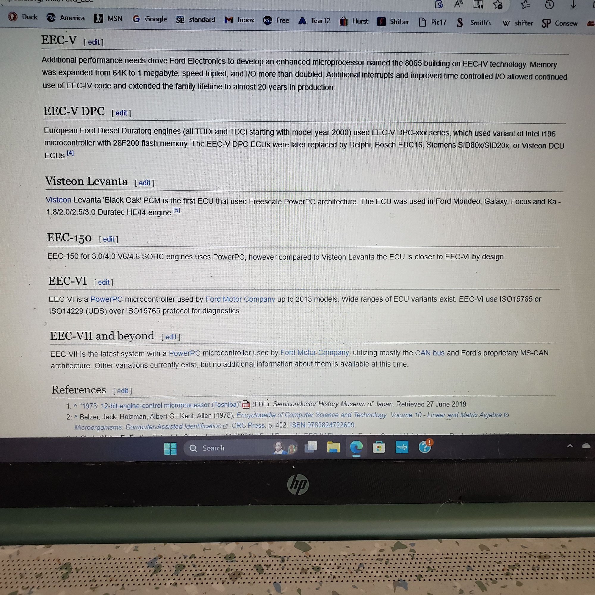

True story, it already has a 105 pin processor
You would have to put a new processor and a new harness and a new engine / trans combo to go from your EEC 5 OBD2 to EEC 6, 7 or 8
There are better systems but come with a newer better? truck
