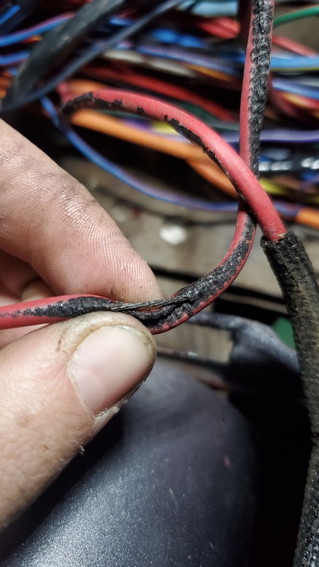

Tore into my wiring harness and found a few problems
1. Green with yellow wire melted to thr passenger side, the reason my passenger door doesn't turn on thr dome light a assume
2. There a 2 wires labeled "resisitor wire do not cut or splice" in my dash, 1 black and 1 red. Idk what the black on is, anyone got a clue? But thr red one I think is the ignition coil resistor wire. It comes from thr ignition (where it shares a plug with a red with green wire) out into a loop and back into thr dash.
The "loop" is burnt real bad and needs replaced
A. can it be the same gauge wire but just a new section soldered in?
B. Can i just cut it and cap it? Or do other things run off it?
C. Why not just run 12v to the coil?
​​​​thanks for any information, need it done soon for graduation photos
Back of the ignition switch with thr resistor wire and red with green wire
Melted/burned resitor wire
Back of the ignition switch with the resistor wire and red with green wire.
D7AZ-12250-A .. Resistor Wire - Ignition Coil - 49" long - Red with Green stripe - 1.30-1.40 ohms resistance (Motorcraft DY-213) / Obsolete ~ Available NOS & from auto parts stores
1977/89 F100/350, Bronco & Econoline // Misc 1977/89 FoMoCo Passenger Cars
Thank you! Is this a special wire or can i solder in a normal wire of equal length/gauge? And what gauge wire would it be, 16?

What kind of ignition system are you using? If it's stock it has to be a resistor wire. Need to find the reason it burned in the first place.
Most likely 16 gauge wire. I'd buy a new resistor wire, splicing the existing wire is a no no.
