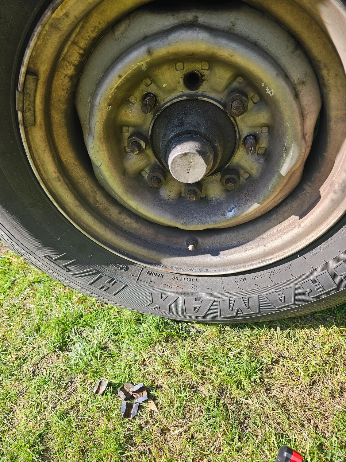

Had a grand ole day yesterday....
Decided to cut them with an angle grinder and a 4 1/2 cut wheel
Was able to find a weird angle where the disc fit, though it did have a few kicks but i didnt do any real damage to the steelies
Was fairly quick work
Replaced both front discs/bearings/seals
Used lucas red and tacky to pack em using the trusty ole hand job method working the shaft vigoursly
​​​with a lil bit o twist, and pushing on the tip at the end
Both spindles were in great shape for who knows how many miles
The timken bearing set had the outter race of the inner (larger) bearing but the disc already had one with a great surface on it, though they came in handy for pushing the bearing on
I used a woodblock and a mallet with the thinner end of the race down, it was just smaller than the seal enough that setting the woodblock on top and taping gently didnt hurt em (prolly should have taken a pic
Did break an old flat tip when i was trying to remove the nuts i cut in half

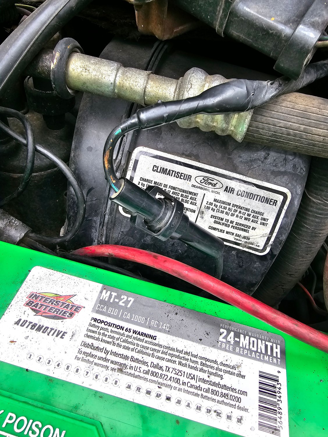

Ill take some pictures of before and after as my new cable set arrived from custombatterycables.com
My old Oem cables are green at the passenger side terminal
The new ones look good heres a pic

Link has black with light blue stripe but turns into two wires after tape section
custombatterycables.com driver negative vs oem
CBC.com at 3oclock
Got the custombattercables.com set in
Unfortunately it wasnt a fix for the drain
but at least ive eliminated it as a possibility and updated a badly needed system i guess
The only battery cable that had any exposed wire was the passenger negative near the engine
The driver positive was shorter than oem but as shown in the 3 oclock i got it routed to not be in any moving parts
Wasnt able to make use of the rubber covers for the terminals really so if youre a fellow e350 7.3idi owner keep in mind you want a longer driver neg cable i guess
Ill try to see what fuse has the drain asap
