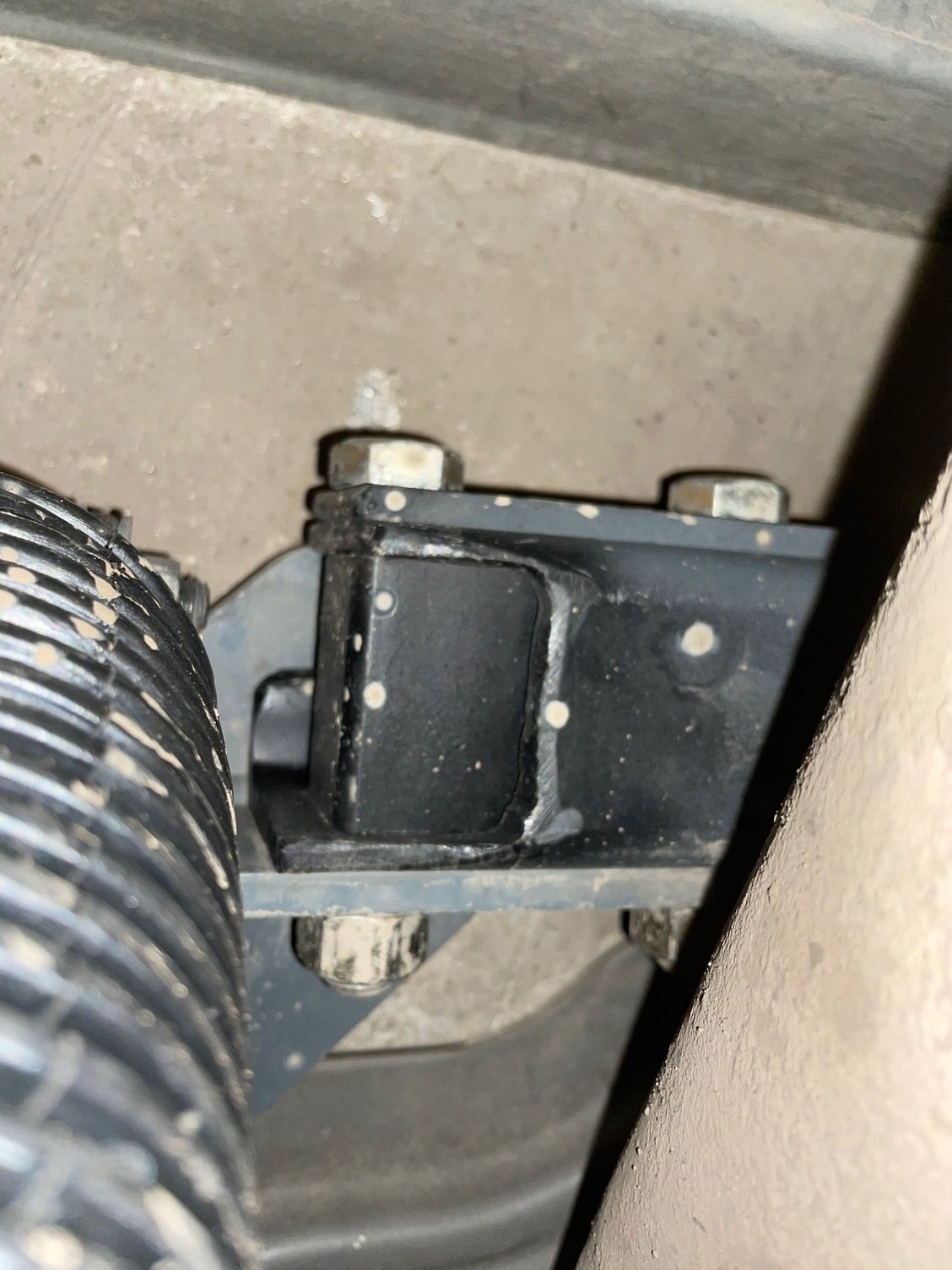

I want to do shocks soon but I have a b&w flip gooseneck ball in the bed and I hear that completely get in the way of changing shocks. In fact I’m betting new shocks would make a big difference. I’ve got a set of those and the steering shock as well to do. I try to keep getting projects ready so I can tackle them when I get some time especially since the mileage on the truck

The factory rear shocks with the B&W is a slight PIA. You have to remove and notch a crossmember. I made a spacer after the fact from square tube so the bolts wouldn't crush the unsupported flange. Once the factory shock is out I could now change the slightly differently designed Blistein 5100's without any problem, and without having to remove the bolt or spacer. This is looking striaght up from the bottom, shock boot on the left, upper shock nut can be seen at the top. kind of hard to figure out what I did without seeing it stock but that is what it looks like after notching and fitting a spacer (painted black)

got it, I think. The crossmember is part of the b&w hitch correct? I hear those are a huge pita to try to do anything with but I’ll try just about anything to be able to replace them. Thanks! I’ll use yours as a reference!

I found the instructions. Hopefully since I am outside of the rest belt there bolts will come out easier.
