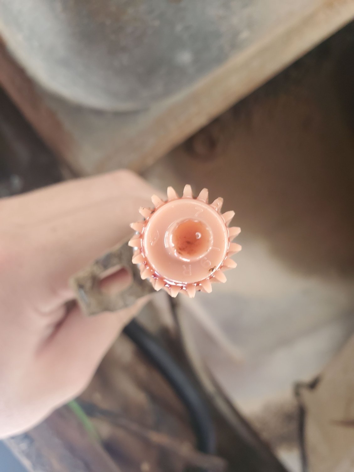

This is what my gear looks like and the gear on the inside feels about the same but I couldn't get an angle to look in there.

The colors are just for the different speedo gears for different trucks. Don't worry about the color.
