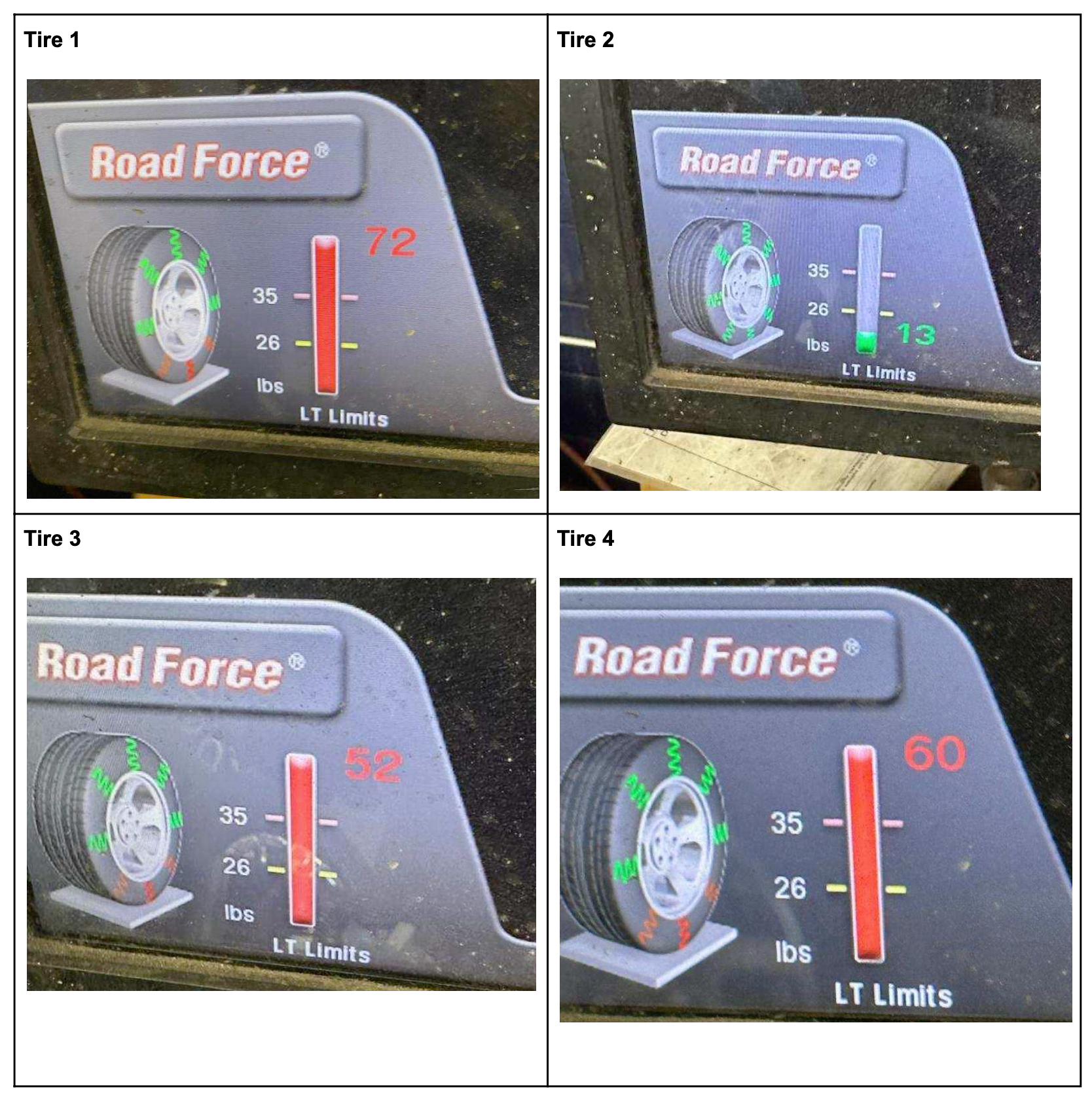

So with all that said, what you do guys think? Tire issue? Shock absorber issue?
Below is the road force indicators from the dealership.
I'm having a vibration issue with my brand new truck. One tire had a ton of weight, so I Road Forced it using my own machine. it was 56 lb and 58 lb (ran it twice).
Hunter claims 40 is the limit for LT tires. My Ford service guy claims 45 rear, and 35 front on my F250. I think 3 out of 4 of your tires are no good.
It also sounds like at least one set of tires got rid of the vibrations. Sounds like enough info for me to say it is tires.
I would also not assume that the second set of donor tires were good (as it sounds like the vibrations came back with that set).
My 14 Mustang had a rear tire with a ton of weight on it. I thought it was a fluke, but then my 17 fusion had horrible Goodyear AS's
on it (vibrated like crazy until Mich 4SPS's put on, then smooth as glass) and now this brand new truck.
I'm convinced Ford knows they have at least some marginal tires, specifically putting worse tires (one's with a lot of weight) in the rear.
If the customer complains, maybe they will do something. If not, they saved money yet again.

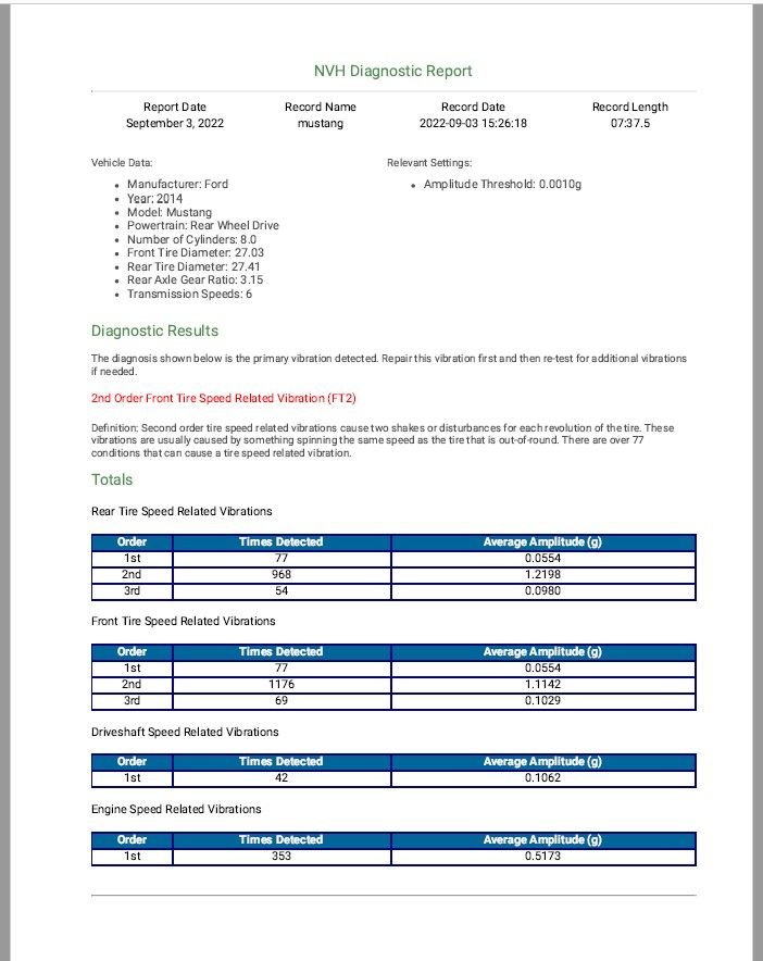

Besides my RF machine, another thing I have been playing with is this vibration app. Not cheap as far as apps go @ $100, but it seems to work pretty well.
It helped diagnose a driveline issue I had on my 14 mustang. The rubber around the carrier bearing was shot, and that thing only had 11K miles.
http://luxjo.supermotors.net/MUSTANG...630_150645.mp4
I went crazy for almost a year with multiple sets of wheels and tires, never thinking it could be driveshaft with that low miles.
Anyway, you put in trans ratios and tire diameter(s) and it can tell which vibrations come from either engine, driveline, or axles/tires.
(I don't think it would help with anything suspension or steering)
This is a report I did for fun on my Mustang with drag radials that flat spot like crazy after sitting (even parking with "flatstoppers"). I live about a mile from a highway.
As soon as I get to highway speed, you can see tires with a second order vibration of over 1G. After 8-10 miles, they "round out" and get way better at about .1 G's.
You do need a really good windshield mount, or some other way to mount your phone solidly to the vehicle.

That is a crap load of data... Wow. Interesting app.
