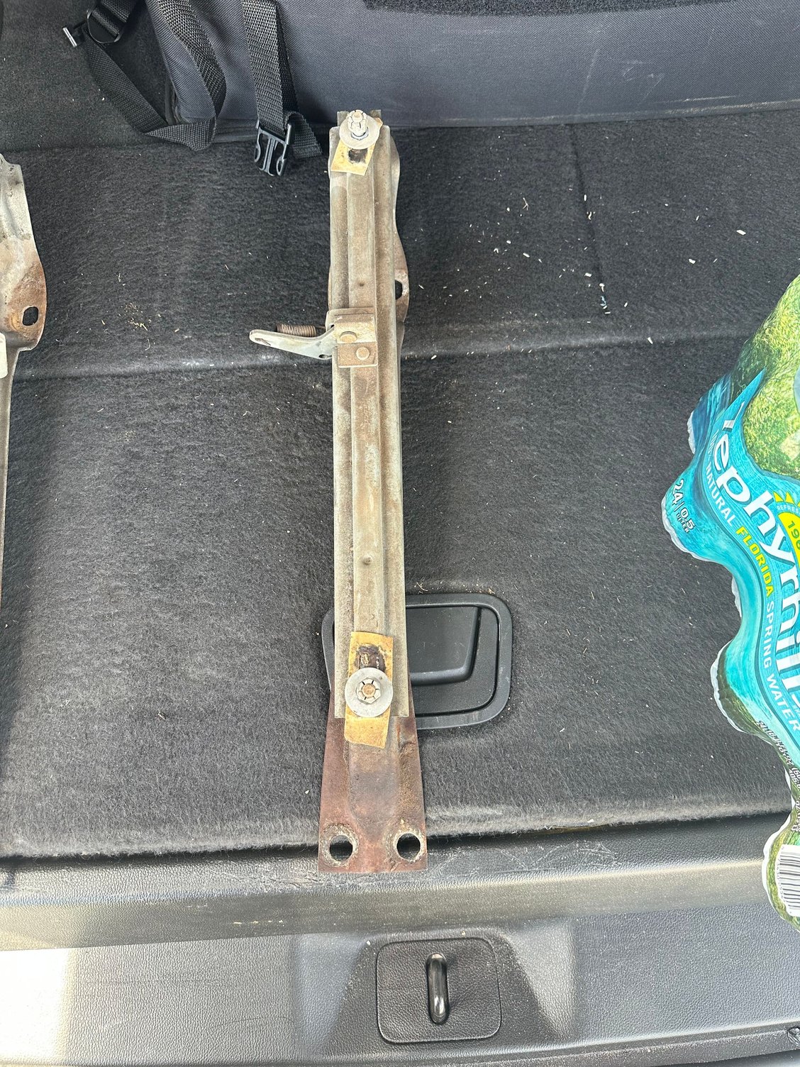

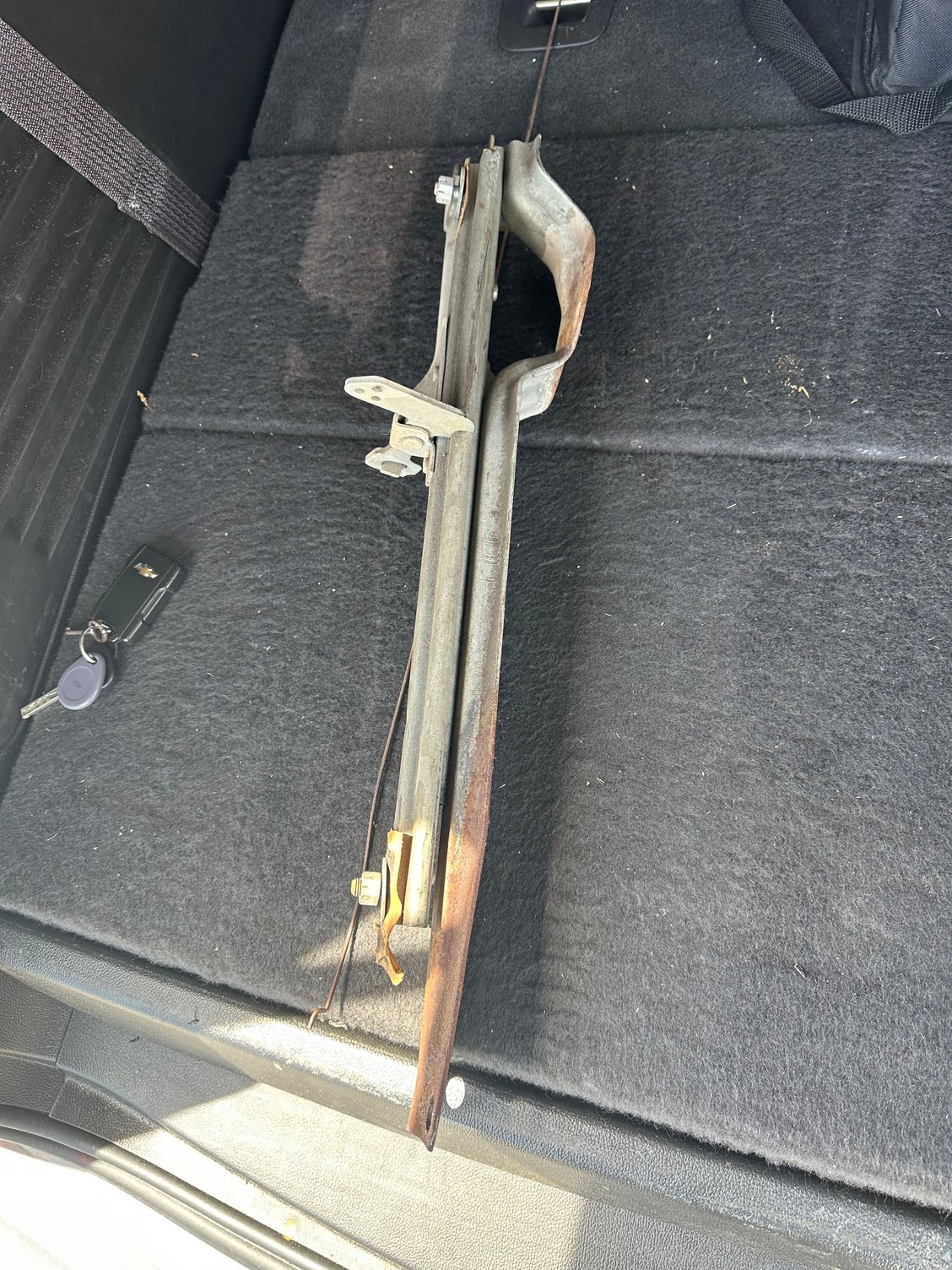

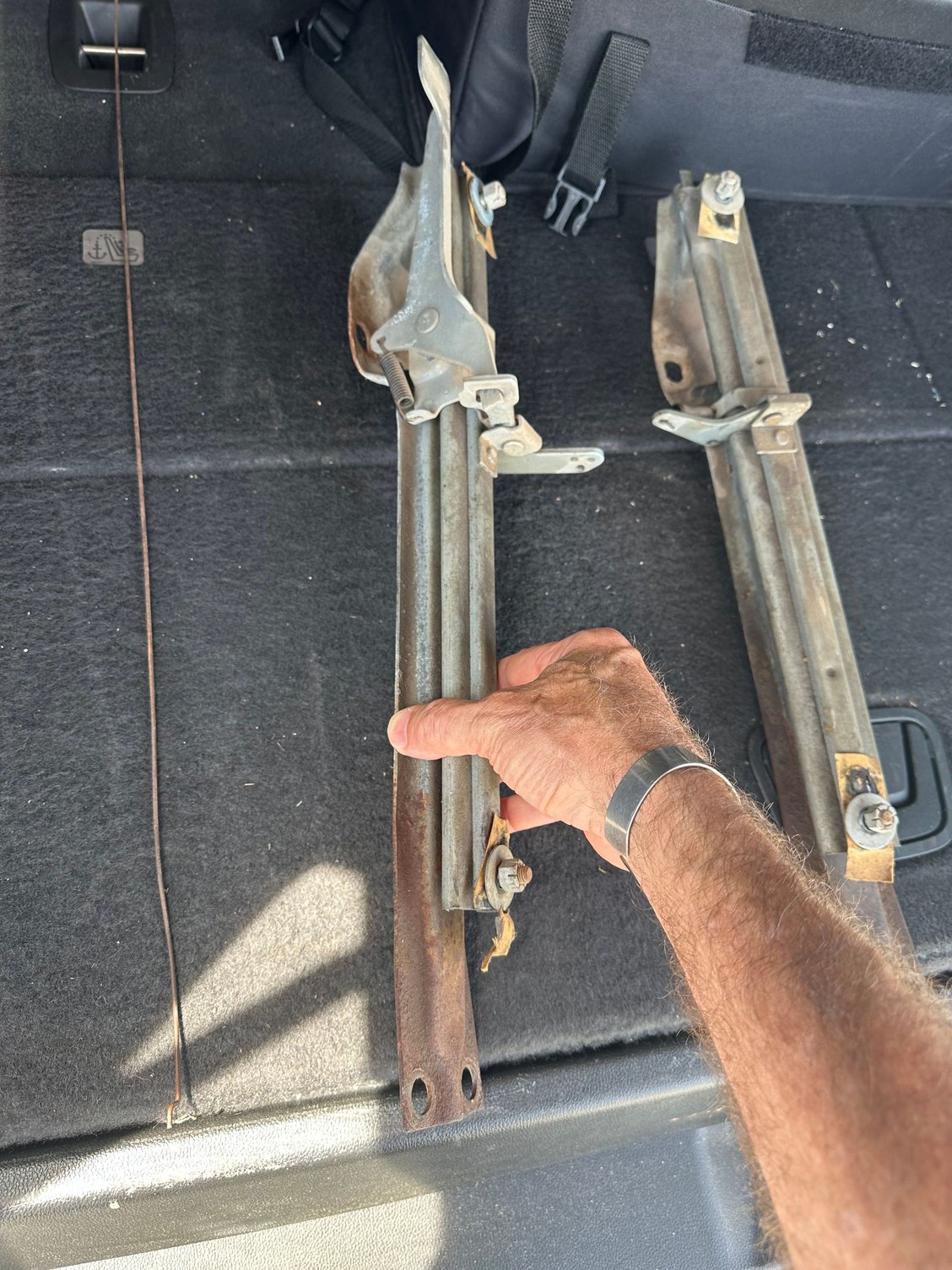

Looking for some guidance…. The seat track assemblies for my 1963 unibody are toast …. The bearings are mostly missing. I’m having a hard time finding replacements. Does anyone have suggestions? Will later model tracks work? Any input is much appreciated. Does any one rebuild these?

Originally Posted by Packard
The seat track assemblies for my 1963 unibody are toast. The bearings are mostly missing. I’m having a hard time finding replacements.
1961/66 F100/1100 / 1963/69 N/NT500/1100
C1TZ-8161704-A .. Right Seat Track - Use with full width seat / Obsolete
GREEN SALES CO. in Cincinnati OH has 1 = 800-543-4959
CARPENTER NOS PARTS in Concord NC has 2 = 800-476-9653
C1TZ-8161705-A .. Left Seat Track - Use with full width seat / Obsolete
No Ford dealer or obsolete parts vendor has any.
Using the Ford part numbers, see if anyone on ebay is selling these seat tracks.
