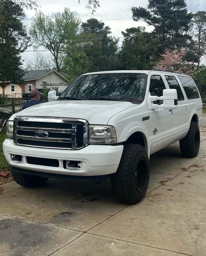

This is how the Excursion sits. Only a leveling kit on it and 18’ wheels

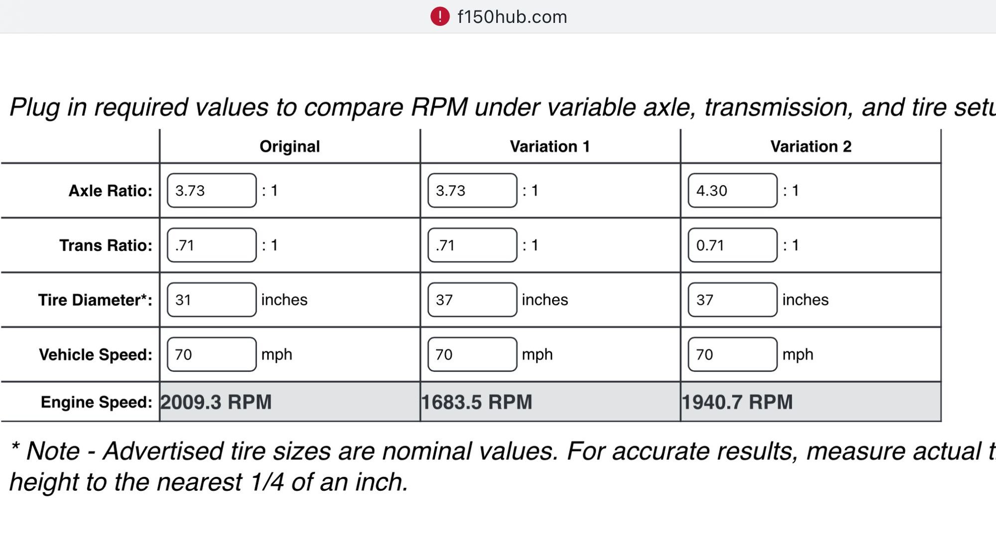

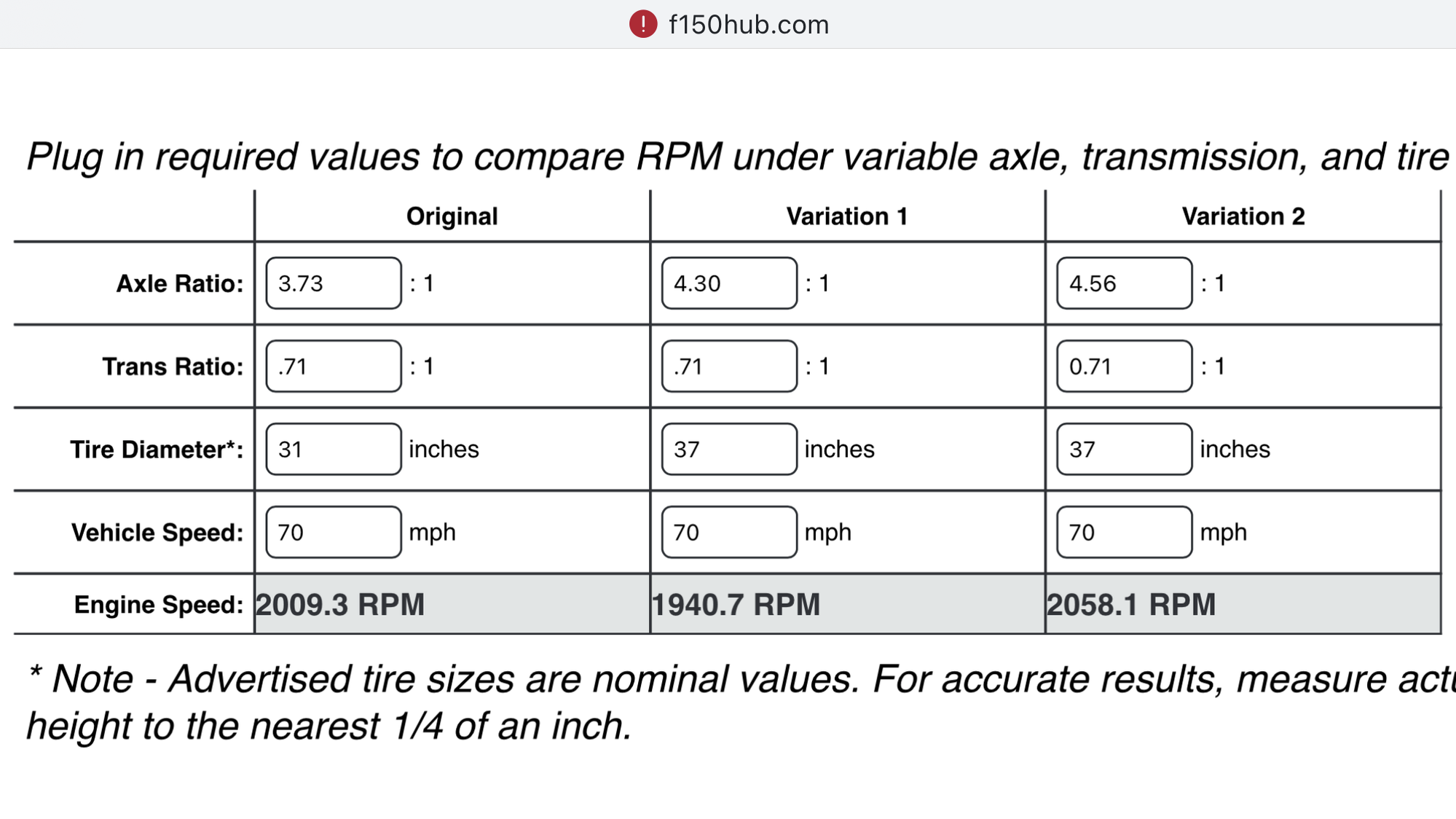

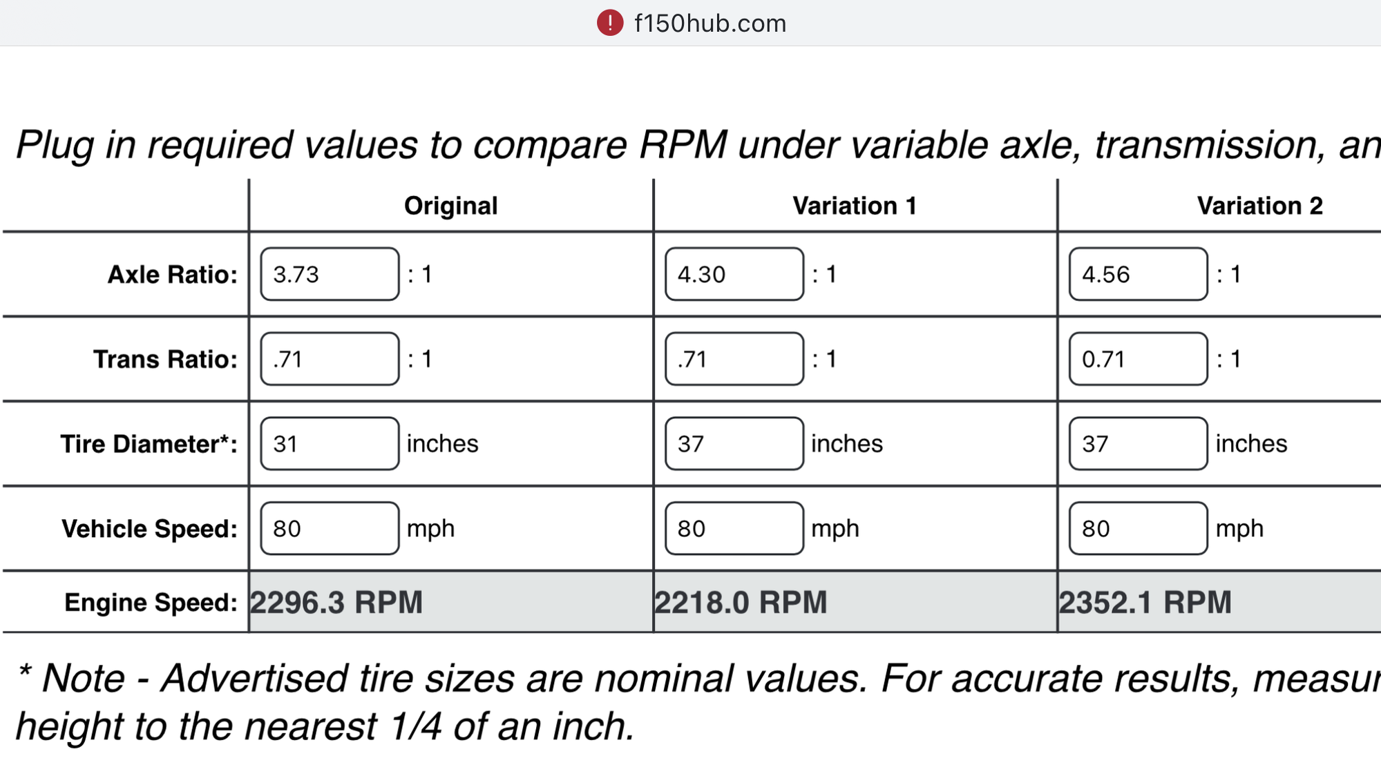

Goggled a gear ratio comparison tool and found this site. https://www.f150hub.com/tech/axle-ra...ison-tool.html
Plugged some comparisons in for you. Watch for ratio changes, mph changes, and tire size differences. The first column is always “stock” as I figured this would give a baseline back to the way it was designed. Pay attention to the differences in rpm.
Biggest thing to note is seeing a “night and day” difference between the vehicles with 35s and 37s leads me to questions other setup differences and potential issues like leaking uppipes. I imagine there would be a difference you can feel but that drastic of a change doesn’t seem supported by the “small” difference in rpm. Can you share setup differences between the two? How about looking for boost or uppipe leaks?
Stock, current setup, 4.30’s at 70mph
Stock, 4.30, 4.56 at 70mph
Stock, 4.30, 4.56 at 55mph
Stock, 4.30, 4.56 at 80mph
