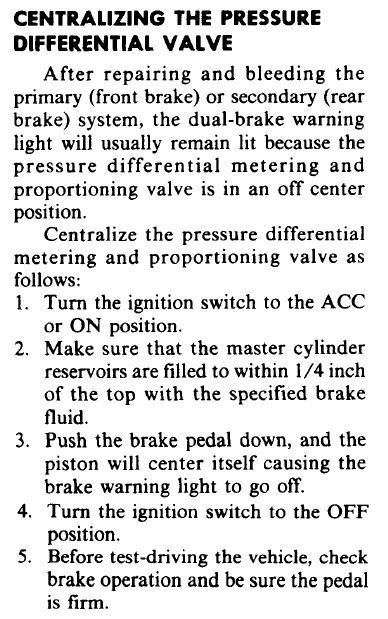

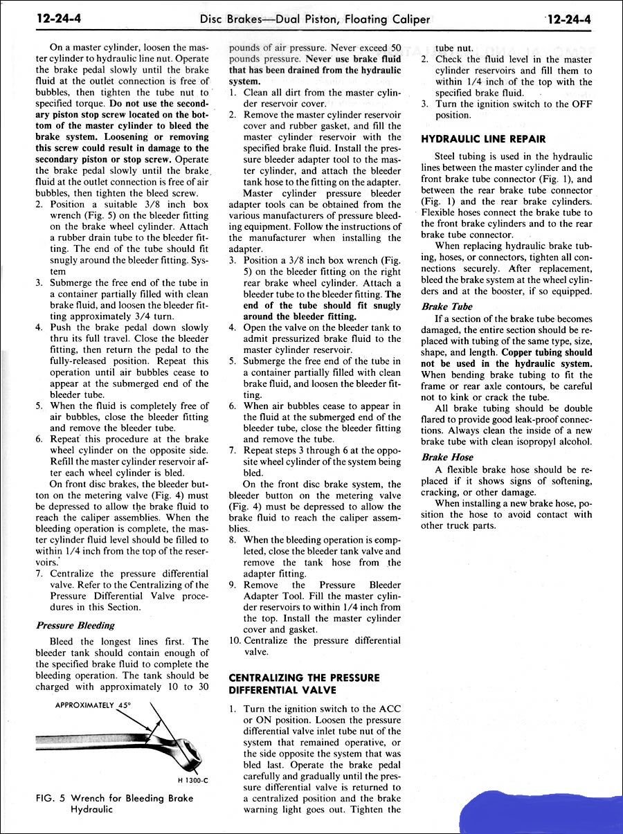

UPDATE:
I purchased a prebent kit line kit from inlinetubes.com - they really made a pretty nice product. Although, after inspecting the set, it was clear that someone had moved the prop valve previously because it was no where near where the lines said it should be. Additionally, one of the fittings for the master cylinder didn’t fit properly. I ended up cutting and putting a new fitting and flare on the line, got it all back together, then promptly broke the brake pressure warning light sensor! Lol. I ended up replacing: the front L and R hoses, two hard lines from the master cylinder to prop valve, and the entire rear lines and hose.
After replacing the sensor, making sure everything is nice and tight, I proceeded to bleed the brakes with a friend. We used the pedal method, topping off the reservoir in between switching tires for bleeding. Then holding the brake pedal down with pressure in the system, reinspected all fittings, hoses and lines for leaks, none were visible.
Then, turned the engine on, the brake light went off. When I drove it down my driveway the pedal went squishy. Rechecked all fitting, still no leaks.
What would cause the loss of pressure or squishy pedal?
Sorry for the novel! #TLDR
