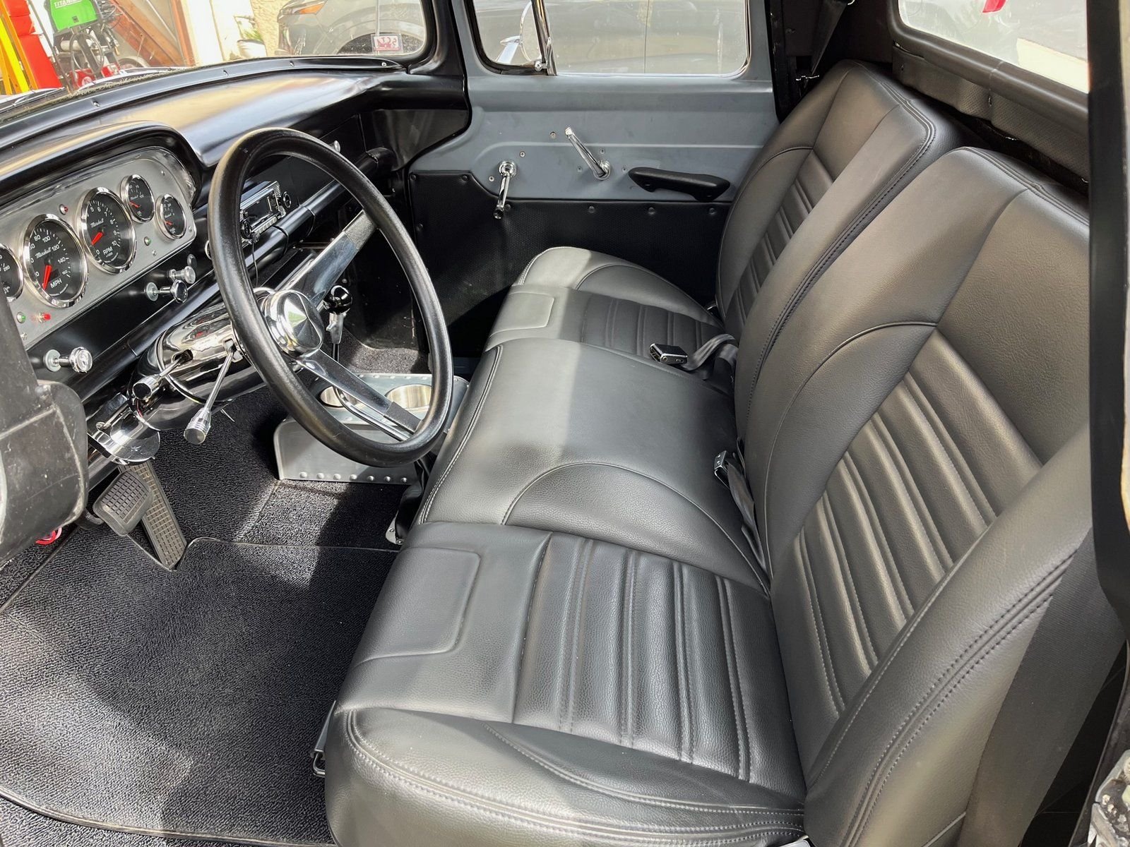

I'm 5'10' 150 lbs. Mine has tilt and a TMI bench with backrests that recline. Honestly it's okay for short runs, and it's tolerable for 100+ mile trips, but the word comfortable isn't exactly what comes to mind. I tolerate it because I like the truck, but these cabs are cramped. I have boosted brakes and cutting a pie slice out of the brake pedal, bending it and re-welding it so it's closer to the level of the accelerator made a substantial difference too.
