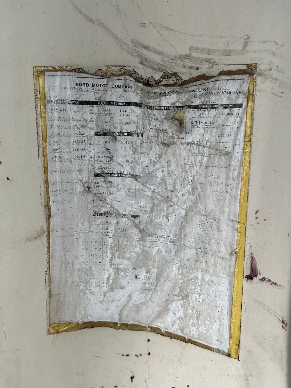

This is all that's on the door
Above pass seat

That’s the original build sheet Lots of good info there
70 amp alternator
Can’t read all the numbers but it has a Eaton 13 spd trans
38000 lb Hendrickson rear suspension
16000 lb front axle
Eaton rears with 4.88 gears
Lot more info and original part numbers
Take a photo and preserve it
There’s more info there on your truck then most will ever have
