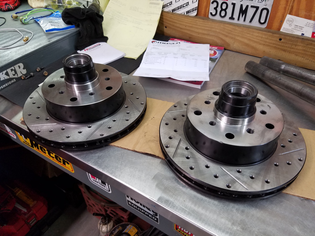

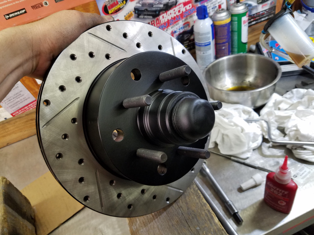

Wheel choice does suck for 5.5" BP. I converted my 95 Lightning to 4.5" BP. Drilled rotors and turned down the outer dia of the hub.
