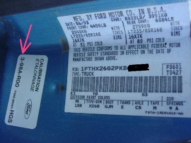

Is the calibration code on the driver’s side door jamb?
Post the number and someone will be able to tell you what PCM belongs in the truck.
