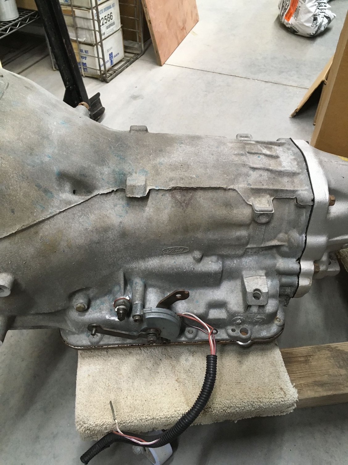

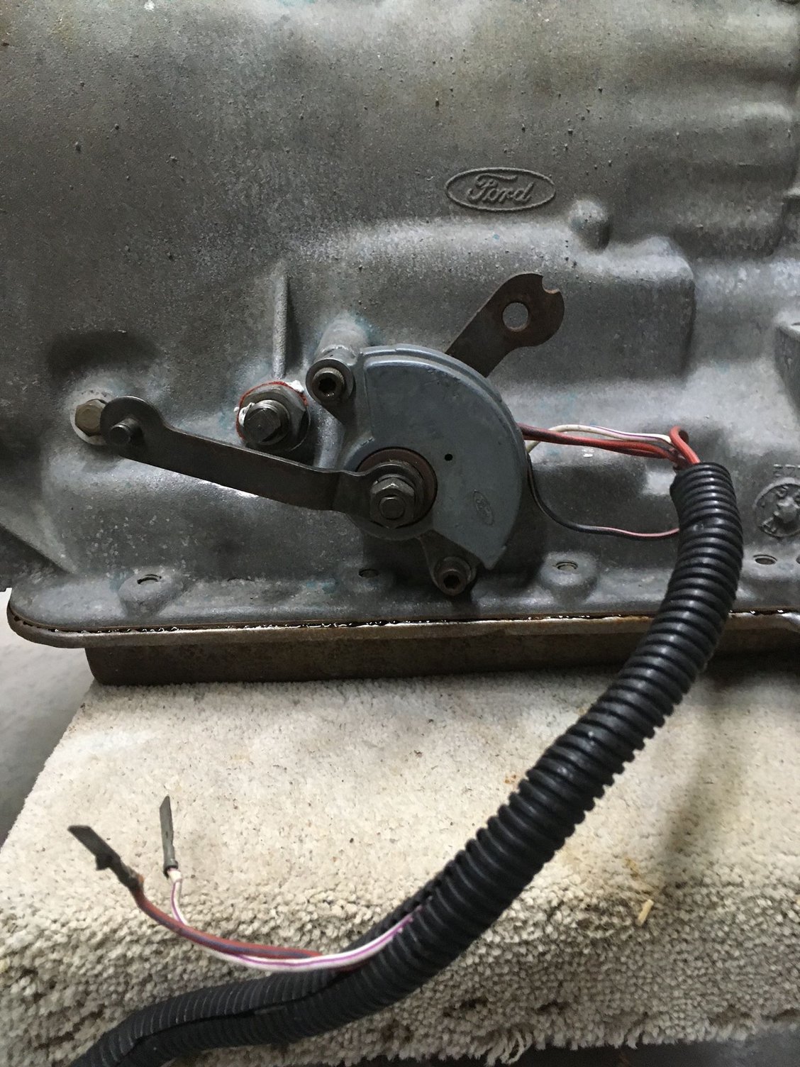

Hey Crop Duster, sorry for the long delay but just now managed to get a few photos of the C6 linkage. This will be running behind a 289 block stroked to 331. And thanks for the advice on the kickdown cable. We may also be using a Lokar unit for the accelerator pedal. The prior owner jerry-rigged just about everything on this beast including installing a SBC!

C6 manual lever

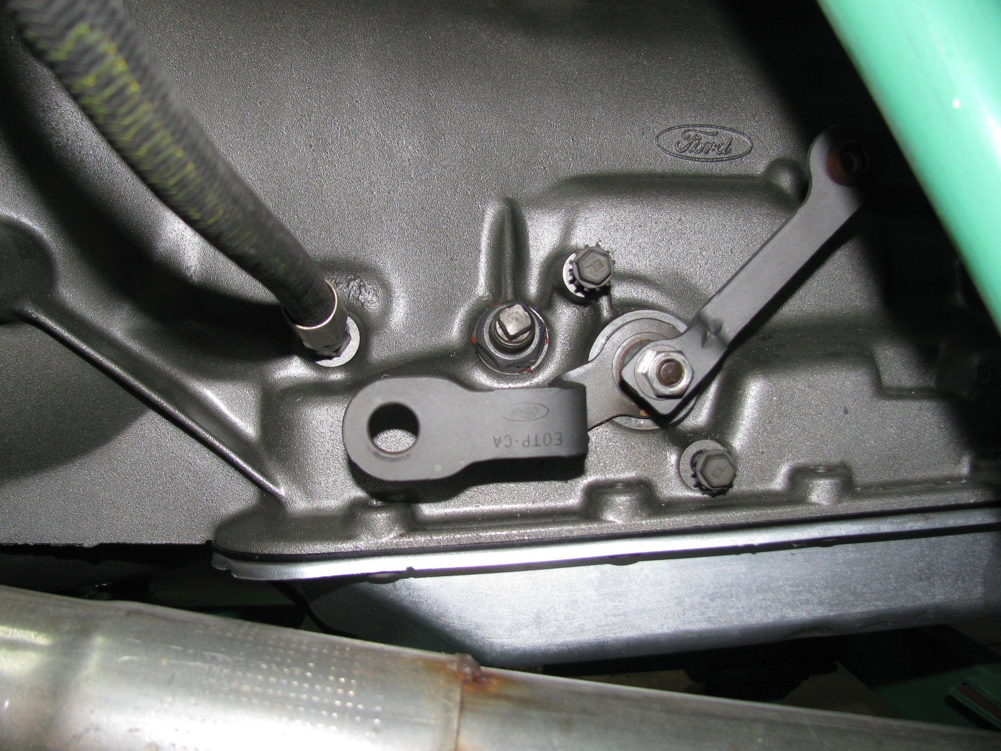

I'm going to say that the manual lever in your trans won't work in a 2WD truck. I'm sure ND will correct me if I'm wrong here but most 4WD trucks and possibly some 2WD's in 78 or 79 used a lever that pointed up, one I have is marked D8TP-BA, but they had a compound type linkage that will be hard to find. Your best bet is to try to source a column from a truck that had a C6 in it originally say 68-79. That way the shift indicator and the detents in the column will be correct. There are two manual levers that I have used that will work the one for a column with the NSS on it was marked D3TP-CA. And the easiest solution because these are still available new since they were used in forklifts long after Ford quit using the C6 in trucks. Is one marked E0TP-CA. To use it requires a small modification, after it is in the trans use two small crescent wrenches heat it with a torch and bend it up until it is parallel with the pan rail. This lever also has the slots in it for a trans mounted NSS so it can be used with any column you get.
Here is a pic of one in a C6 behind an engine on my run stand. Disregard the kickdown it just there to keep things tight.

Thanks ND and CD! It appears that since we have the NNS on the tranny it is 78-79 era. The reason we were attracted to this unit was that is already had a GV unit attached and the price was right. Getting that working is a whole other issue!
So I guess we would be searching for a lever with number E0TP-CA. Sounds like the mod is relatively simple. On the one you are showing us, did you already bend the lever parallel to pan? Or was that not necessary in your case?

I use the E0TP-CA because they are so easy to find and cheap. I got the last one from a local transmission shop for $10. You will have to heat it and bend it to make it work correctly with the 68-79 column. On the other hand, there are probably others that will work that I am not aware of. If you use a 68-77 column you can use the D3TP-CA which doesn't require any modifications. Here is an e-bay store that has both. You will notice how many different ones there are, and this is only the tip of iceberg and one of the reasons people get in trouble by just sticking any old C4 or C6 in a truck.
You have to remove the valve body to change one. You should install a new seal and kickdown "O" ring at the same time.
