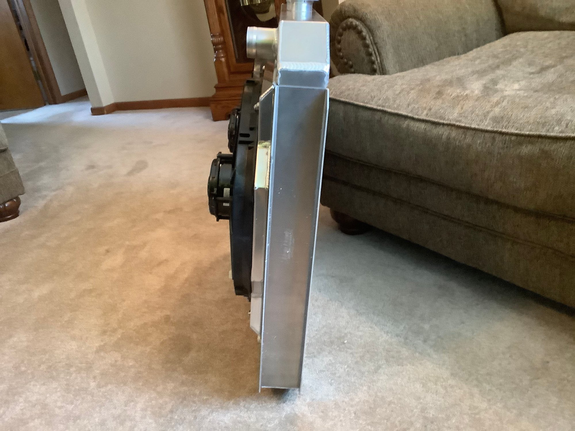

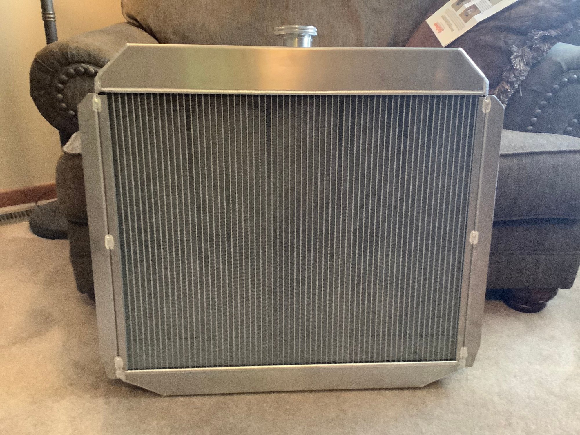

Ron Davis, fit like a glove! Even had to put a regular thermostat back in it because it was running to cool with the thermostat with a bypass. By too cool I mean my Edelbrock Pro Flo 4 wouldn’t get up to temp to activate the learn program. Highly recommend the ground kit on all aluminum radiators.
