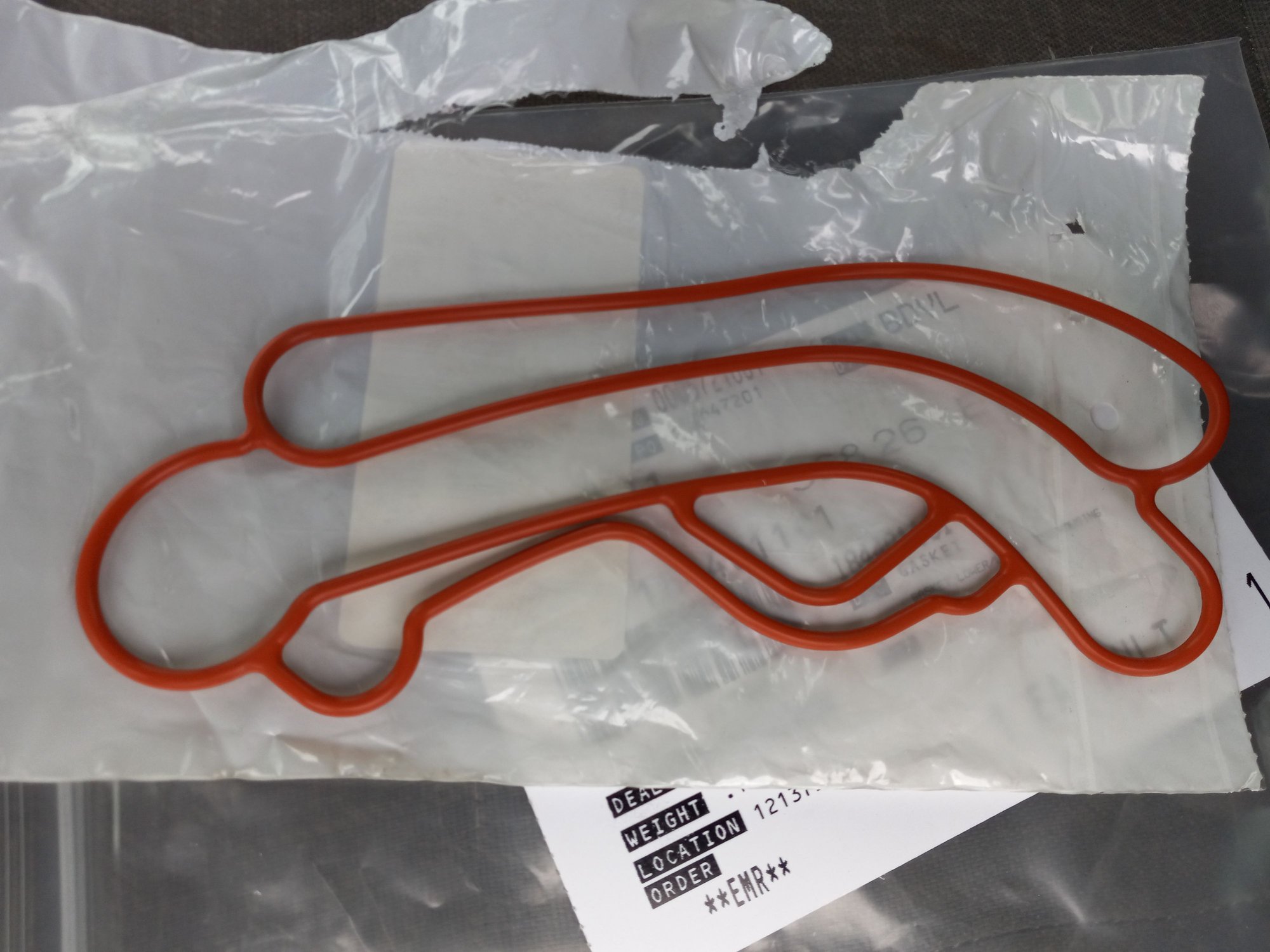

Slowly turning this in to my new tow rig. Just chasing gremlins. Shuts off completely once it reaches 185F . Thinking It's the ICP or IRP worst case it's both. Already replaced the oil gasket that goes bebteen upper and lower oil filter housing.

Do you by chance have the part number for that gasket you pictured above?
